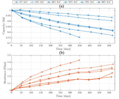

Calendar aging of NMC Li-ion cells at 50 ℃ at various SoCs. (Credit: Wiljan Vermeer, IEEE, 2021)

After 500 charge cycles and 167 days, these three groups (fast, slow, 50%) were examined for remaining battery capacity. As one can see in the above graphic for the Android group and the similar one for iOS in the video, the results are basically what you expect. Li-ion batteries age over time (‘calendar aging’), with temperature and state-of-charge (SoC) affecting the speed of this aging process, as can be seen in the SoC graph from an earlier article that we featured on built-in batteries.
It seems that keeping the battery as cool as possible and the SoC as low as possible, along with the number of charge-discharge cycles, will extend its lifespan, but Li-ion batteries are doomed to a very finite lifespan on account of their basic chemistry. This makes these smartphone charging myths both true, but less relevant than one might assume, as over the lifespan of something like a smartphone, it won’t make a massive difference.

  1. The graph on the top shows that fast charging does – contrary to what the article says – not degrade the batteries faster. The capacity loss with fast charging was lower than with slow charging. But I would expect that the effect is not statistically significant as the variance is quite high.
    1. Yeah, after reading the article, I’m still not sure what the results were (now I have to actually watch the video).
      And using the statement “…the results are basically what you expect.”, in an article about challenging popular thought is less than useless; it is actively confusing.

  4. As I understand there is 500 cycles for each group of the phones/batteries. So no wonder that 80 to 30 group “aged” much less – it went thro “half” of the energy back and forth vs other groups.
    1. Yep. If one battery is charged and discharged more during the same period of time to reach the same number of charging events, the load is going to be different and the two cases are no longer comparable.
      Lithium ion cycles are not calculated by how many times you plug them in, but by how much charge is put through relative to the nominal capacity. There’s actually two definitions of this: a cycle is either one nominal charge which may require multiple actual charges to accomplish, or one actual charge at the battery’s current state of health which is dropping over time.
      The latter is more common as it’s easier to track, but it results in the same error because it means cycling the battery at the same charging interval to reach the same number of charging events means that the load on the battery must be dropping over time, whereas in reality what happens is that people see the battery go down sooner and charge it up more often.
    2. Please rewatch the video – at 1:20, they explicitly state: “Since each round only uses 50% of the battery, we count that as half a cycle.” To me this means that they would have undergone 80-30-80 1000 times to reach 500 complete cycles of the battery.
      They don’t account for battery state-of-health from what I remember, so Dude’s comment about that introducing error could still apply.
      1. “To me this means that they would have undergone 80-30-80 1000 times to reach 500 complete cycles of the battery.”
        This is assumption.
        Bit of clarification from the author would be great.
        This is also assumption but has at least some logical correlation with data – This could also mean 500 half-cycles… and as it happens life of battery is down half of the other ones (100 0 100).
        One more sentence from the author can solve that easily.
