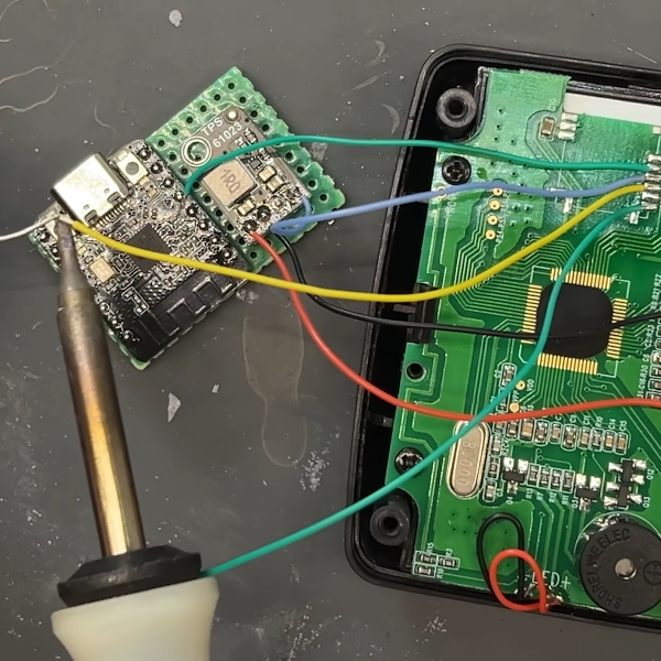

[Mellow Labs] wanted to grab a multimeter that could do Bluetooth. Those are cheap and plentiful, but the Bluetooth software was, unsurprisingly, somewhat lacking. A teardown shows a stock Bluetooth module. A quick search found a GitHub with software. But then he had a fiendish idea: could you replace the Bluetooth module with an ESP32 and use WiFi instead of Bluetooth?
This was as good an excuse as any to buy a cheap logic analyzer. Armed with some logic captures, it was easy to figure out how to fake the meter into thinking a Bluetooth client was connected.
Oddly enough, the data is “encrypted” with XOR, and an AI website was able to identify the raw data versus the encrypted data and deduce the key. The rest, as they say, was software. Well, except for one hardware problem: The ESP32 needed more power, but that was a fairly simple fix.
The entire thing fit the case beautifully. Now the meter streams a web page instead of requiring Bluetooth. Great job!

    I wonder whether the AI just picked up the XOR key from the website that the video also used as a reference.. they keys in https://github.com/FireMarshmellow/DMM_Web_interface/blob/main/python/ble_dmm_min.py and https://github.com/ludwich66/Bluetooth-DMM/wiki/Bluetooth-DMM-10-Byte-Data-Protocol appear identical.
    No mention about the battery life after the mod :)

        The battery compartment is a huge hole with a nice set of covers. Why not replace it with a LiPo battery, usb charger and a Low-Standby-Supply Current regulator? Should all fit in and has a nice cover.

    I still think using esp32 to bridge the wifi and BT is more practical (smaller battery drain on device, no hardware mods needed). Integrating this to Home Assistant would be really cool for creating ad hoc automations. Something like:
    If voltage in this battery falls below that level turn off this wifi socket, turn this wifi bulb to red color and send me notification.
