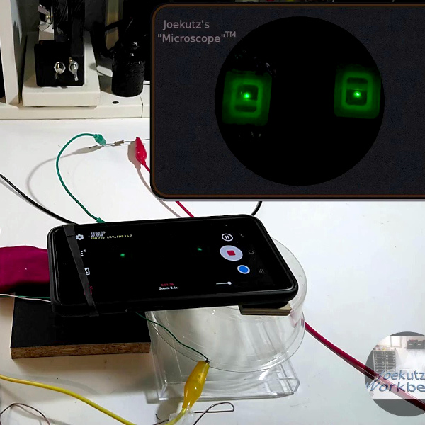

The power just has to come from somewhere, and if you’re not paying for it there’s the bonus. [joekutz] has just such a project, lighting up LEDs with no power source or other active electronics.

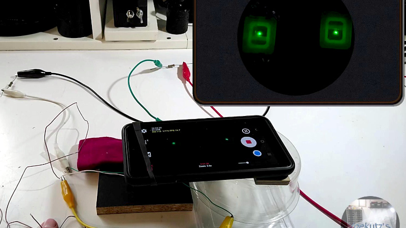

Of course, he’s not discovered perpetual motion. Rather, while an LED normally requires a bit of current to light up properly, it seems many will produce a tiny amount of light on almost nothing. Ambient electromagnetic fields are enough, and it’s this effect that’s under investigation. Using a phone camera and a magnifier as a light detector he’s able to observe the feeble glow as the device is exposed to ambient fields.
In effect this is using the LED as the very simplest form of radio receiver, a crystal set with no headphone and only the leads, some wires, and high value resistors as an antenna. The LED is after all a diode, and it can thus perform as a rectifier. We like the demonstration even if we can’t quite see an application for it.

    2. Joekutz here :)
      OK that is hilarious to imagine, and clearly the same effect that I saw in my experiment.
      In fact, my Idea with the LEDs came because once I was wondering whether I can just tape an LED in front of my adjusted-to-complete-darkness eye with a long wire attached to each leg and see flicker. I didn’t do that experiment (probably works :) ) , but the experiment is still from that idea.
