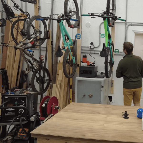

Biking can be an incredibly rewarding hobby, but what do you do with all of your expensive pieces of metal and composite when you aren’t hitting the trails? They take up space that you could use for more bikes! [Chaz] figured there had to be a better way and discovered the unlikely solution of the humble garage opener.
Garage doors are made to lift high with moderate weight, exactly what one would expect from a bike lift. If you have high ceilings in your garage or wherever else you store your bikes there can’t be much easier than pushing a button to get your bike out of the way.
To assemble the unusual bike rack, [Chaz] mounted the motor to the wall with a few scraps of wood, and built a wooden platform that rides along the rail. This additional board allows you to use a traditional bike wheel rack to gently raise the bike. While initially [Chaz] had some questionable results, this was quickly resolved with removing the rotational elements of the mount and allowing a slight slant in the bike.

    3. You can pull the bike sideways so high ceiling is not a prerequisite.
      I also fail to see the excitement over garage opener motor when plain rope you pull and tie to an eye bolt would suffice.

      1. I had similar fix in my garage since 2005. It is a standard low-ceiling 8 feet one, but there is a half-roof open crawl space above it, so I utilized that. Years back there was no hackaday, so I invented and built things myself without sharing with anyone – the solution was a winch a block and some steel cable. Later, when we no longer needed bikes, the same 300lb rated solution was repurposed to raise/lower a punching bag instead. Works fine to this day, 20 years later, slightly upgraded (safety hook and beefy rachet stop were added so that it won’t just suddenly decide to unwind itself under tension).

  2. I know this isn’t buyaday but I’m very happy with my manual bike lift from Aldi. You could make your own with a couple of pulleys too. Also good for kayaks.
