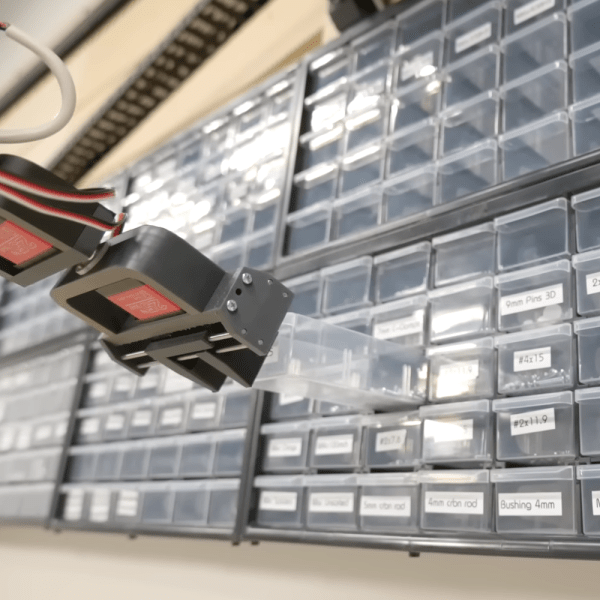

[Engineezy] might have been watching a 3D printer move when inspiration struck: Why not build a robot arm to clean up his workbench? Why not, indeed? Well, all you need is a 17-foot-long X-axis and a gripper mechanism that can pick up any strange thing that happens to be on the bench.
Like any good project, he did it step by step. Mounting a 17-foot linear rail on an accurately machined backplate required professional CNC assistance. He was shooting for a 1mm accuracy, but decided to settle for 10mm.
With the long axis done, the rest seemed anticlimactic, at least for moving it around. The system can actually support his bodyweight while moving. The next step was to control the arm manually and use a gripper to open a parts bin.
The arm works, but is somewhat slow and needs some automation. A great start to a project that might not be practical, but is still a fun build and might inspire you to do something equally large.

  1. Needs a label printer in the manipulator, so it can label a bin when something new is stored.
    Maybe a laser to etch the bin?
        1. Since the robot can’t read; what’s the point? You search for a part on the computer, and the robot feches the right drawer for you. No need to label anything. Just put the drawer reference in the stock system. Screw_Countersunk_Hex_M3_20mm – drawer 47
          1. Robot should be doing all that indexing itself.
            Next step is voice control – I shouldn’t have to fuss around on the computer, just a wake word and a part description without looking up from whatever it is I’m working on.
  2. He does mention in the video that all the tools were in pre-determined spots during the cleanup routine so I can
    The whole design is pretty good, but the hard work has yet to begin.
  3. A better solution to the saggy drawers problem might be some kind of support plate. It would have to be movable to prevent it getting in the way of the gripper and anything it was carrying.
    1. This was my thought. It needs a camera on the manipulator to be able to identify screws and nuts and things and put them in the correct drawers.
  4. Automating this is probably possible in the near term, though picking individual objects out of a pile is an unsolved problem. Once you can grab individual items, identifying what they are and dropping them in the right bin is more doable.
