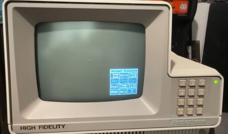

The concept of remote video calls has been worked on since Bell’s phone company began pitching upgrading from telegrams to real-time voice calls. It wasn’t until the era of digital video and real-time video compression that commercial solutions became feasible, with the 1985 Image Data Corporation Photophone CP220 being an early example. The CP220 is also exceedingly rare due to costing around $25,000 USD when adjusted to inflation. This makes the teardown and repair on the [SpaceTime Junction] channel a rather unique experience.
Perhaps the coolest part of the device is that the manual is integrated into the firmware, allowing you to browse through it on the monochrome CRT. Unfortunately after working fine for a while the device released the magic smoke, courtesy of the usual Rifa capacitors doing their thing. This is why a full teardown was necessary, resulting in the PSU being dug out and having said capacitors swapped.
After this deal the device powered on again, happily accepting a video input and saving screenshots to the floppy drive before it was replaced with a FDD emulator running FlashFloppy firmware. Unfortunately no video call was attempted, probably because of the missing camera and having to set up a suitable POTS landline for the built-in modem. Hopefully we’ll see that in an upcoming video to see what we common folk were missing out on back in the day.

  5. To be honest, the system looks a lot like a custom PC running custom software.
    At first blush (trying to get a good view in the fast pans is hard), there is an AMD x86 processor, some BIOS chips, probably 256k of RAM, and a bunch of ISA slots. That floppy controller looks very much like a PC controller for the original 5150!
    Personally, I would be very tempted to have a close look at the layout of the slots: could they be ISA pin-compatible? Would the cards be recognized in a standard PC? Sure, the advanced frame grabbing or keying functionality may not work – but would it output any video?

  6. I can’t believe he replaced the exploded RIFA capacitor with another RIFA capacitor. They should be replaced with a suitable polypropylene X or Y class capacitor.
