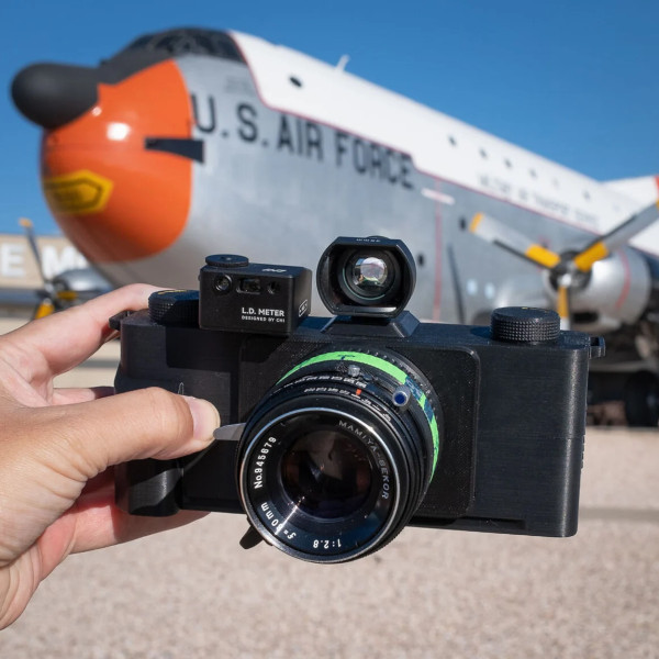

Even though digital cameras have lowered the barrier of entry to photography dramatically, as well as made it much easier for professionals and amateurs alike to capture stunning images without the burden of developing film, the technology behind them is considerably more complex than their analog counterparts. In fact, an analog film camera (not counting the lens) can be as simple as a lightproof box and a way to activate a shutter. Knowing that, any kind of film camera could be built for any number of applications, like this 3D-printed panoramic camera from [Denis Aminev].
The custom-built camera works by taking a standard roll of 35mm film, which is standardized to take 36 pictures, and exposing a wider section of the film to create a panorama. This reduces the number of pictures on the roll to 19. This is the fifth version of this camera, called the Infidex 176 V, and has everything a standard film camera would have, from an exposure counter, pressure plate for the film, a winder, interchangable lenses, a viewfinder, and a tripod mounting point. It does take a bit of work to assemble, as shown in the video linked below, but the final result is impressive and delivers a custom finished product not easily found or reproducible in off-the-shelf cameras.
The path to creating this camera was interesting as well, as [Denis]’s first custom film camera was a pinhole camera. From there he moved on to disassembling an SLR camera and attempting to reproduce all of its parts with 3D printed ones. With that in hand, he was able to modify this design into this panoramic camera which he likes because it reproduces the feel of widescreen movies. Although this camera reproduces all of the bells and whistles of a high quality analog camera, not all of these features are strictly necessary for taking pictures on film. Have a look at this minimum viable camera as well.

  1. Nice work, interesting aspect ratio, and gorgeously large film area.
    But how do they get off calling a camera with a 17×45 degree field of view “panoramic”? To be fair, they’re just copying Hasselblad’s (and others) format name, but still…
    My “ultrawide” 10 mm makes a 90 degree wide image (on a APS-C sensor), and even it certainly doesn’t qualify as panoramic.
    At least Hasselblad offered a 30 mm lens for their Xpan, which would have made it the same 90 degree field of view as 10 mm on APS-C.
      1. Or Cinemascope, although that works with distoring lenses, and is something entirely different.
        But those cameras that spin around are super cool, and I’ll admit I was kinda hoping this was one of those. :)
        Still. Awesome build.
  2. I think panoramic refers to the image ratio (width vs length), and anything bigger than 1,5 or 3/2 is called panoramic by all camera makers.
    The panoramic ratio of analog APS cameras was 1,8, not so wide.
    Hasselblad (in fact Fuji ;o) made also available a 90 mm for the X-Pan…
