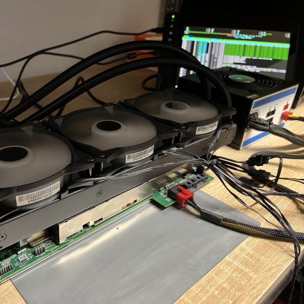

The BC250 is what AMD calls an APU, or Accelerated Processing Unit. It combines a GPU and CPU into a single unit, and was originally built to serve as the heart of certain Samsung rack mount servers. If you know where to find cheap surplus units of the BC250, you can put them to good use for AI work, as [akandr] demonstrates.
The first thing you’ll have to figure out is how to take an individual BC250 APU and get it up and running. It’s effectively a full system-on-chip, combining a Zen 2 CPU with a Cyan Skillfish RDNA 1.5 GPU. However, it was originally intended to run inside a rackmount server unit rather than a standalone machine. To get it going, you’ll need to hook it up with power and some kind of cooling solution.
From there, it’s a matter of software. [akandr] explains how to get AI workflows running on the BC250 using Ollama and Vulkan, while noting useful hacks to improve performance like disabling the GUI and tweaking the CPU governor. The hardware can be used with a wide range of different models depending on what you’re trying to achieve, it just takes some careful management of the APU’s resources to get the most out of it. Thankfully, that’s all in the guide on GitHub.

  2. No mention of how this is a PS5 APU on GDDR memory? Just cut down from 8 to 6 CPU and only 20 GPU compute. Apparently Bazzite has put back the deprecated patches needed to use the GPU?
    Also be informed that you can get non-bootable ones and flash the BIOS with a CH341A clip, it’s what I did.
    If you are serious the cheapest way to get them is in the actual 4U enclosure. Then you get (shocking I know. . .) Fans, PSU and an enclosure!?!
