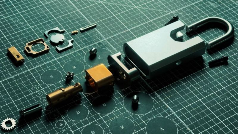

Throughout the centuries the art of lock-making and lock-picking have been trapped in a constant struggle, with basic lock designs being replaced by ever more complex ones that seek to thwart any lockpicking attempts, as well as less gentle approaches. When it comes to the very common pin-and-tumbler lock design, the main issue here is that the keyway also provides direct access to the lock’s mechanism. This led [Works By Design] to brainstorm a lock design in which the keyway is hidden.
The ingenious part here is that because the actual key is rotated away after insertion, there is no clear path to the pins. This did require some creative thinking to have a somewhat traditional style key as well as a way to turn the internal mechanism so that the key would be pressed against the pins. Here inspiration was drawn from the switchable magnet mechanism as seen with e.g. magnetic bases. This ensures the key and key handle can be detached and attached quite firmly.
After many 3D printed prototypes, a metal version was CNCed and subjected to some early testing by a locksmith, who even with having seen the CAD model of the lock was stumped. With this initial result and some user feedback in the bag, it was time for large-scale testing with more lockpick enthusiasts, as there are many more ways to open a lock beyond pushing pins. That said, a mechanism was also added to the lock to prevent bumping attacks.
The next testers were found in the Lock Pickers United community, one of whom raised the issue of an impressioning attack. With a couple of test locks on their way to said lockpicking enthusiasts it’ll be exciting to see whether this new lock design will set the standard for future locks or not.
I love this channel, and this lock is very cool as a concept, BUT…More than anything else, a lock in the real world has to be robust. I think this key is not (the magnetic haft is going to get separated and lost), the lock is trivial to destroy by over torquing or putting gun in the slot and rotating it. Again, nothing against this lock. I think it is very cool, but I don’t think it will ever replace more traditional locks.

It’s a prototype.
You can readily increase its robustness with replacement materials.
A pick proof lock isn’t impossible to break through: it’s just that breaking into it leaves a physical trace, which is important.

This type of lock exists, but I’ve only seen it in very rare safes. The operation is to insert the key completely into a hole, close the cover and open the lock. The key will be returned after the door is locked. The Forever Lock attempted something similar, where their latest iteration is overcomplicated. This is a great prototype demonstrating the concept, and it may stand the scrutiny of the lockpicking community. Mostly as the plastic pin will mash up, and likely result in the lock being inoperable after an impressioning attempt. I would like these locks to be more widely than just influencers. Where several lockpickers, me included, will certainly give it a run for its money. We have decoding strategies which work on very much any lock in a lab setting.

The magnets in the tube are weak. If it is combined with a long tube, so the “shaft” part of the key is fully encapsulated by the tube when retracted, then there is no chance of accidental separation. It also obscures the bits from being photographed.
Add some extra gears, the place where you rotate the key is the same as where you insert it. This makes it easier to operate (Just insert and rotate). It also solves the On/off magnet part, because the “bits” are sheared off when the key starts rotating.

In a standard lock picking scenario you’re probing and picking the lock at the same time. In this case I think you could make a probe key for each pin (reducing the complexity to log2 of the number of combinations), insert them one by one, calculate the correct “combination” and fabricate the correct key. Maybe you could have a blank key as reference and then see how the lock responds to different “bits” set.
Picking insert/blank with pressure sensors? It exists? For this lock we need detachable one.
2^9 = 251 ?!?…. just double it while counting down 9 fingers, binary is not that difficult.
Lets say you have two keys — you bought a few of these locks — if you insert the wrong key into the lock and one of the pins drops below the sheer line, your lock is now permanently blocked, no way to remove that key, no way to push that pin back up to get the key out.
This design should allow for more combinations. Normally keys are limited, they can not go from one extreme position to the other. Since this key does not slide in, but rotates in from the side, more combinations should be possible, maybe.
This is not the first lock that “swallows” the/a part of the key. The old one has been openend using foil impression.
