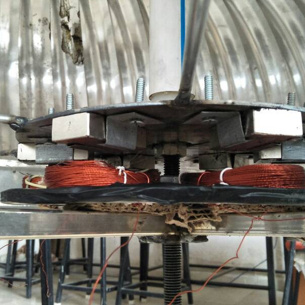

Have you ever looked out across the rooftops of a city and idly gazed at the infrastructure that remains unseen from the street? It seems [varunsontakke80] has, because here’s their project, harvesting energy from the rotation of a rooftop ventilator.
The build is a relatively straightforward one, with a pair of disks with magnets attached being mounted on the ventilator shaft inside its dome. A third disk sits between them and is stationary, with a set of coils in which the magnets induce current as they move. A rectifier and charge circuit completes the picture.
This appears to be part of a college project, but despite searching, we can’t find any measure of how much power this thing generates. We’d be concerned that it might reduce the efficiency of the ventilator somewhat. There will be an inevitable tradeoff as power is harvested. Still, it’s a neat use of a ubiquitous piece of hardware, and we like it for that.

    2. Stop and take a breath. Then realize that this will only work if there’s air movement in the first place.
      Yes, it extracts power from the airstream. Yes, it would impose some backpressure doing so. Yes, it probably even reduces the flow somewhat. But in order for it to work at all, there must be ventilation happening.
      And, yes, it’s obvious it could be engineered more efficiently. But as we know, that’s HaD’s raison d’être: To be a forum for those who need to blat about other people’s inefficient devices and faulty thought processes.
      1. Also, you only need a certain amount of ventilation, and anything more than that doesn’t improve things any. A generator like this will load the ventilator down proportionally to the rate at which it is spinning. At the minimum speed necessary to provide sufficient ventilation, it probably won’t generate much power at all, and once it IS generating significant power, that’s power that is in excess of what was needed for ventilation.
      2. that this will only work if there’s air movement in the first place.
        The way these generators work, they need really high RPM to generate any useful power. To remedy that, you need to add iron cores to the coils and decrease the air gap to a minimum to increase the magnetic flux density through the coil. Once you do that, the magnets get aligned to the iron and you need a fairly high torque to get it spinning. It basically gets stuck.

      1. They don’t do anything more than a non-moving vent of similar cross-sectional area, though. The spinning comes from extracting some of the energy of the escaping hot air, so it actually is less efficient.
        They got popular simply because they look cool.
        1. My understanding though I have never seen one in person was they are vastly better than the non moving vent as a rule, as they are using the outdoor wind to actively drive the desired airflow – its not meant to be powered by the indoor air its venting.
          It might well sometimes be spinning because of the air its venting should the day be very still, in which case yes its probably going to be less efficient, though even then maybe not as a more complete mixing of the vented air and the ambient air might well actually create a bit of extra pressure difference at the outlet and so higher airflow through the vent.
          1. Yep. They’re centrifugal fans spun by wind.
            The criticism still applies: it’s basically like a savonius turbine. They have a relatively narrow optimum tip speed ratio (basically, RPM needs to match wind speed in a narrow range) and if the load isn’t well matched they will bog down.
            In a design like this, once the generator voltage exceeds the battery voltage, it will be like hitting a brick wall – the generator will initially offer no load, and then all the load the battery can sink because a slight increase in voltage will drive a high current, so the RPM won’t rise much above the point where the battery starts charging. If the wind speed goes up, the turbine will lose torque and power as it becomes saturated by spinning too slowly relative to the wind. If the wind speed picks up even more, the turbine stops. If the wind speed drops below the charging RPM, the turbine will spin idle and generate no power.
            So it will be generating power only in a narrow range of wind speeds, and while it’s doing that, it’s reducing the effectiveness of the vent.

  3. It’s some sort of R&D project so part of it is to learn something, many above say it won’t work – and they may very well be correct. However I would like to see more data, how much power is produced for what conditions, does generating power slow the ventilator down too much, data where the generator is switched in and out, air flow up the shaft and so on. Doing the extra data will teach the student much.
    But getting much data is the first step, maybe the system could be modified to produce more power. Good luck to the team
    1. This appears to be a master’s level project in a college.
      The only figures given in the report they have written is that the generator supposedly makes 500 mA or 18.5 Volts at 885 RPM. The report doesn’t indicate whether this was measured separately or concurrently, or what was spinning the generator. No other performance stats are given, and no actual evaluation of system performance can be found. It’s not a very good report and wouldn’t pass as a thesis yet, but it would be acceptable as some sort of capstone project.
