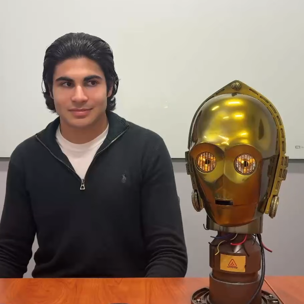

C-3PO is one of the more famous movie robots out there. However, we don’t see a lot of replicas built, perhaps because in speech and mannerisms, he’s quite hard to replicate. Of course, that feat has become much more achievable with modern AI tech, as [Samuel Potozkin] demonstrates.
We’re not looking at a full C-3PO build here, it’s just the head—but for the project’s purposes, that’s all that was really required. The build relies on a Raspberry Pi 5 as the brains of the droid. It’s running a mic hooked up to a real time speech to text engine, and that text is then sent to a large language model for interpretation. Responses are then generated, passed through a processing layer to capture C-3PO’s general tone and vibe, and then handed off to a text-to-speech synth to imitate the iconic voice, played via speaker. The end result is a C-3PO you can actually talk to, which is something that might have knocked a few socks off when the movie first launched in 1977. In-depth materials for the build can be had via Google Drive and on Github.
This ersatz C-3PO isn’t an exact dupe of the movie ‘bot.  The protocol droid is a little slow to respond, and the patter isn’t quite on point, even if the voice synth makes a good effort at mimicking the original. Overall, it’s a little… robotic… something you wouldn’t say of the character in the movies. Still, it’s a great effort, and something we haven’t really seen much of before. If you like more classic droid replicas, though, we’ve featured those too. Video after the break.

  2. Nice project. Perhaps you could have it reply immediately with some random banter while waiting for the answer to be computed. This would mask the latency issues.
