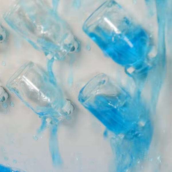

You can get the idea from the header image: each digit is formed by a fifteen-segment display made up of glass bottles. A stepper-driven peristaltic pump and some membrane-pump boosters fills the bottles as needed with dyed water, while emptying is accomplished simply by having a servo dump the water into a trough. It’s an interesting, albeit messy, way to generate a display.
It wasn’t the original idea– well, the bottles were the original concept, but flipping them was not. Dumping the bottles has the advantage of not needing oodles of pumps or taking five minutes to sequentially fill and drain the bottles at each digit. The linkage to get the servo to flip all nine bottles in one go took some troubleshooting– we can relate, since the physical half of such projects usually is the hard part– but after many modifications the 3D printed mechanism worked, and we think the results are worth it.
