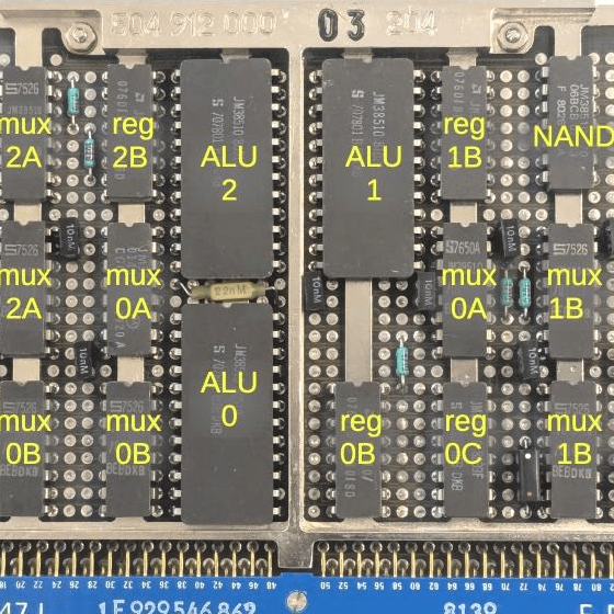

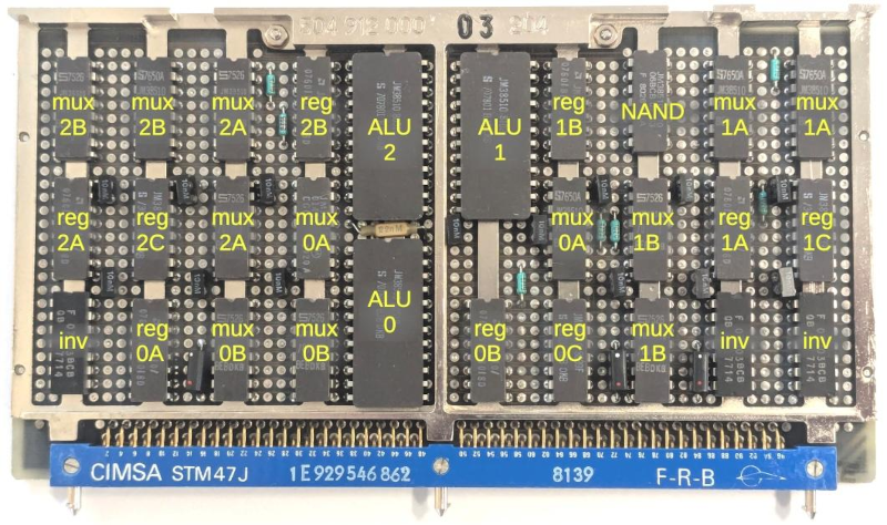

As you might expect, the computer doesn’t contain a microprocessor. Instead, it is a series of cards and, in this post, [Ken’s] looking at the ALU that allows the computer to perform math operations.
The Mitra was a descendant of a 1971 computer, and the “MS” indicated it was a military-grade variant of the computer. Spacelab had three of these. One operated the lab, another handled experiments, and the third was a backup.
At the heart of the board was the 74181 ALU. Well, actually, the 54S181, which was the military-grade high-speed part. Each chip handled four bits of addition, subtraction, or a few other logical operations. No multiply. No divide. Oddly, no right shift, either.
Although the computer is a 16-bit machine, it has a 32-bit ALU built from eight ‘181 chips, spread across several boards. Multiplexers allow the ALU to read different operands, and the result can go several different directions, also.
