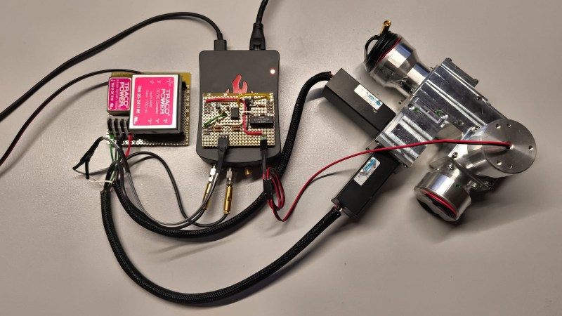

If you ever cracked open one of those Magic 8-Ball toys, you found little more than a polyhedron floating in some dark-colored fluid. It was a quasi-random way of asking the universe to answer crucial questions like “will Mom and Dad get a divorce?” and “does Bethany like me?” even if the results were seldom accurate (sorry about your parents, kid). If you want a more reliably random 8-ball that is not even slightly more truthful, you might like this recent build from [David Noel Ng].
The concept is simple enough — leverage quantum effects that provide truly random results to seed run a random number generator that determines the outcome of a software magic 8-ball. [David] tried a few ways to build something along these lines, and eventually settled on a setup that he felt suited the task at hand.
In the final rig, a light source spits out photons, and is attenuated to the point where effectively only one photon is running through the light path at a time. Each photon passes through a beam splitter, and either passes through the mirror and hits photomultiplier A, or bounces off and hits photomultiplier B. This creates a truly random yes/no result for every photon that passes through. [David] does a great job of explaining the low-level physics at play, as well as the supporting electronics and code that turns this into a usable magic 8-ball that actually answers questions.

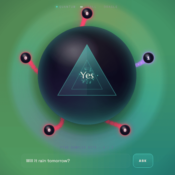

Author here!
I have an endpoint for CLI-dwellers:
curl -X POST https://quantumlever.stream/api/magic-8-ball \
-H “Content-Type: application/json” \
-d ‘{“question”:”Will my sampler touch the multiverse?”}’
And yes, this is directly hooked up the the QRNG device :)

This devices has been tested with the NIST STS suite, on 1.6 billion bits generated on the device, and passed all the tests.
Out of curiosity, how long did it take to generate the 1.6 billion bits?
Magic 8 balls and randomness using quantum effects, I don’t think it gets much better. We can model the ‘physically unknowable’ (ex. was that one black hole emission ‘truly random’?) w/math until the end of time, but maybe sometimes a quantum-influenced “signs point to yes” is good enough?
If we’ve never seen random before (because the absence of proof to show it isn’t, can’t be proof) then now can we really say it exists? I’m not a theologian, I’m just a guy sat in the garden drinking a strong beer after mowing the lawn. But it should be as random as the universe wants us to believe random can be (excluding physical flaws in implementing the device that could introduce bias)
This a math question that has been studied extensively. The current answer is the NIST STS test suite, which was used to verify the output of this device. That is close enough.
