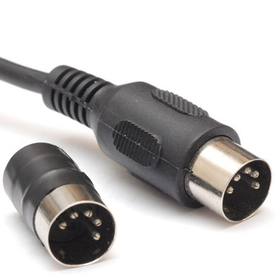

Old Midi Instruments Don’t Like Modern Midi. What’s To Be Done?
In theory, MIDI is an electrical and protocol standard that allows any such equipped instrument or computer to talk to any other. But as the wonderfully named [Knob Monster] will tell you, when the computer is new, and the instrument is old, it ain’t that simple.
They specialise in using the Web MIDI interface to allow browser control of an instrument. This might typically be done with a USB to MIDI interface, but in this lies a problem. The 8-bit microprocessor on a 1983 synth has problems keeping up with the rapid-fire data that spews relentlessly from the supercomputer-grade machine controlling it, and bad things happen as a result.
Expensive MIDI interfaces have a buffer built in, but a better solution lies in the Web MIDI code itself. They detail how to use the Web MIDI API’s built-in packet scheduler to slow things down a little and let your Yamaha DX7 chill a bit.
Meanwhile, if you need a USB to MIDI interface, we’ve covered one in the past.

    2. Good luck with the DRX-1 interface. Computer-side SysEx pacing was our pain too. We ended up sending complete F0…F7 messages on a schedule with midiOutput.send(data, performance.now() + offset) and ~60ms between messages instead of arbitrary byte chunks. Happy to compare notes if you hit a specific failure mode.
  2. Even Back in the 80s, we had tools in sequencers to reduce the density of CC messages. Midi is only 31.25k baud… It’s easy to choke it with continuous controller data.
    Any proper tool should know to rate limit itself.
    1. Yup, came here to say this. MIDI is at a fixed standardized baud rate that even old 80s synths with 8 bit processors could easily handle. I’ve used well designed modern MIDI controllers on vintage synths, I’ve used vintage midi controllers on modern synths, and I’ve used modern cheap USB to MIDI devices on synths. Hell I’ve even used SPG on MSDOS 6.22 to control synths, new and old, over MIDI. The issue isn’t 8 bit processors not keeping up with modern MIDI, it’s lazy modern day programmers not buffering their MIDI properly so that their 31.25k UART line isn’t choked
      1. yep – “The issue isn’t 8 bit processors not keeping up with modern MIDI, it’s lazy modern day programmers not buffering their MIDI properly so that their 31.25k UART line isn’t choked” is the best summary of this article in all the comments.
        I’ve used cheap usb/MIDI controllers on old keyboards for decades, and written my own code to interface. Never had a problem.
        MIDI has proven to be one of those interfaces that has just survived well, which shows it was thought out well in the first place given it’s now been 40+ years…
    2. I was gonna point that out, too, MIDI 1.0 standard were only 31.25K baud, which was kind of sort of okay for simple “multi-timbral” messages (ie, more than one note per, a in “chords” or “multiple instrument played simultaneously”), but once things like mass pitch bends are added (or sys commands) 31K becomes not a lot, really.
      IMHO, 31K was actually quite good for the times when average dialout modem was maybe 1K at best (was it 1983 or 1984? I’d speculate around 1984 when it was widely accepted, but could be as early as 1981).
      That MIDI 1.0 survived largely unchallenged until 2020 (MIDI 2.0) tells me it withstood the test of time rather well – together with simpler/humbler things like RCA connectors (or 3.5mm headphone jack) or RJ45 or CAN bus. Speed was the largest complain I’ve heard from everyone, but I personally haven’t seen any other comparable older/simpler tech standards (in the music industry at least) that would hold that well. Pros have different opinion, and I respect that, but I am just a budget-strangled average Sam, not a 1980s recording studio, and for me it worked spectacularly well even with (what’s now considered old school slow-mo) 31K speeds.
    3. Agreed. CC floods and long SysEx bulk dumps to battery-backed RAM are different problems. We only throttle outbound SysEx when flashing banks back to hardware, not note traffic.

  6. TBH, any decent MIDI device should be able to fully handle constant data at 31.25kbps.
    I could see a few failure modes, though:
    If the USB to MIDI device sucks, it could be dropping bytes of a full MIDI packet if the buffer is full.
    With SysEx messages, all bets are off. You need to send those messages as the manufacturer intended. Theoretically, this could include throttling messages, especially if it’s writing non-volatile memory.
    BTW, when you say “modern MIDI,” I think MIDI 2.0, which is an entirely different beast.
  7. The fact that was midi was a standard that a few companies actually agreed on in the 1st place and then mostly followed for many years is/was almost unbelievable today. The MPE midi mess that exists today is a perfect example of how things normally go.
    That being said any modern midi gear that doesn’t rate limit the data it sends is just junk / badly made!!!
  8. Even back in the early 90’s, my Win98/MPU-401 and Emu-Proteus required a Cakewalk configured byte delay for successful sysex patch bank transmission. The 10 bits of each midi byte flowed at MIDI 31.25 Kbps. Cakewalk was configured to delay each sysex byte by about 100 microseconds to slow the overall sysex byte rate.
    For a recent effort to get my old equipment to work with a modern laptop/USB MIDI interface, I hacked together a basic CLI sysex tool using the linux ALSA RawMidi interface. https://github.com/don-bski/WrkFile2Mid/tree/main/syxmidi. There are also other tools; MIDI-OX, Bome SendSX.
    1. This is the real-world precedent. Cakewalk byte delays and your ALSA syxmidi approach are the same idea we hit from the browser: slow the sender, not blame the DX7. ~60ms between complete SysEx messages with scheduled Web MIDI sends fixed our flash path. Nice repo, will poke at syxmidi.
