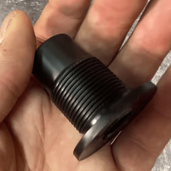

[Do As I Do] had a simple task to complete. A couple of small parts needed to be duplicated in some quantity, with good dimensional accuracy and surface finish. There are a number of ways you might go about this, particularly if you have the original tooling or a machine shop on hand. In this case, however, the plan was to duplicate the parts with silicone molds.
The first step, naturally, was to produce the silicone molds. Doing this involved some craft supplies, with glossy paper and hot glue used to create a vessel for casting silicone around the original parts. The silicone itself was mixed carefully and poured into the vessels, and soon enough [Do As I Do] had a pair of negative molds that could be used to produce duplicates of the original. The original parts were removed, and the silicone molds were filled with resin over and over again to make as many duplicates as were needed.
This was a simple enough project with straightforward geometry that suited the process. More challenging parts would require more care in mold prep and more advanced techniques. Depending on material choice for the duplicate parts and other factors like intended final application, extra steps like degassing may be necessary, too. Still, for a quick guide on duplicating a simple plastic part, it’s hard to beat.

      1. I didnt bother watching it so im not sure about the part you are speaking about but so you know, Tin cured silicones have no issues with mSLA resin prints. Only platinum cure silicones cure inhibit. So as long as you dont need a clear mold, its not really an issue.
        1. I was talking about the thumbnail. They did not use a resin printer anywhere in the video or the process but the AI generated thumbnail shows the parts with resin printing supports as if the parts had been resin printed. In reality a silicone mold was made from the physical part to be replicated and resin poured into the mold and it was done in two pieces that connect mechanically but the thumbnail shows it resin printed as a single piece.
          It seems like the AI generating the thumbnail just saw resin and assumed it was printed and that the creator could not even put in the effort to check that the generated thumbnail was right.
  2. Scale modelers do this kind of thing to copy parts, so go look up some modelling sites for more details because this video glosses over some bits that may or may not be important in particular cases. Firstly, resin is brittle, so the copy probably won’t be as durable as the original. Also, resin forms bubbles when curing and some skill is needed to get rid of some of them but I don’t believe there’s a perfect solution.
