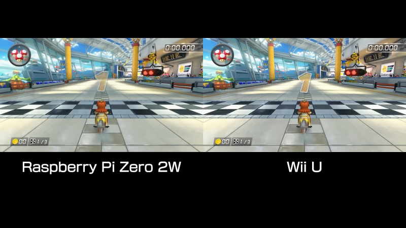

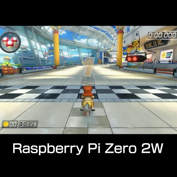

The issue came up during [MattKC’s] work on cloning the WiiU gamepad. The idea was to receive the video stream from the WiiU console and display it using a Raspberry Pi Zero 2W. He had some problems with latency, wherein there was a strange 3 frames of latency in the video pipeline that just wouldn’t go away. Even substituting in some dummy frames into the pipeline and ignoring them at output time didn’t work—the latency stuck around. Eventually, [MattKC] realized the delay wasn’t about a certain number of frames—it was about time. About 50 milliseconds, in fact.
Drilling down further revealed that there was a problem in the way frames were being fed into and received from the decoder. The first frame would take about 50 ms to decode, while later frames would take far less—as little as 5ms. However, [MattKC’s] code wasn’t set up to grab frames as soon as they were done, so the lag carried forward. The video explains it in greater detail, and how polling the decoder regularly helped solve the issue. The final result was a Raspberry Pi Zero 2W that could process and display the WiiU video feed as quickly as the original Nintendo WiiU gamepad.
