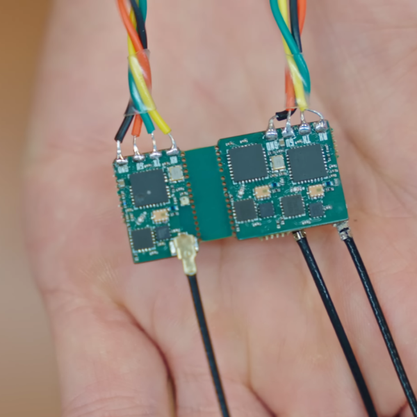

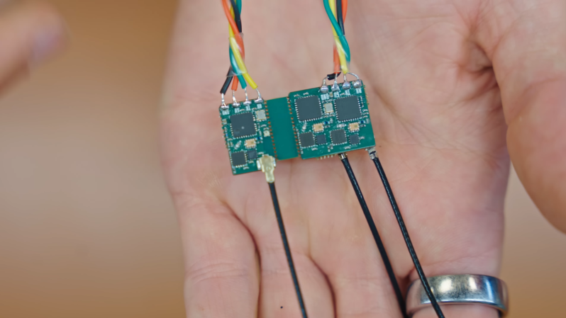

A man's hand is shown holding two small circuit boards, joined together by a central bridge. Each circuit board is connected to four wires and a coaxial antenna cable.
Drone control links are, from a radio signals perspective, nothing short of amazing: using a transmitter capable of transmitting, at most, one watt, a protocol such as ExpressLRS (ELRS) can control a drone over 100 kilometers away. [Stan], who has been building a drone electronics stack from scratch, recently designed four ELRS receivers and went over the principles behind their incredible range.
Up to a certain point, the simplest way to increase a radio’s range is to lower the frequency; lower radio frequencies penetrate better through most materials and don’t attenuate as quickly with distance. However, although ELRS can use 900 MHz bands, [Stan]’s receivers primarily use 2.4 GHz. The major improvement is in modulation: unlike other control protocols, which mostly use frequency modulation, or Wi-Fi, which uses phase and amplitude modulation, ELRS uses Chirp Spread Spectrum modulation. This has a low data rate, but it’s very reliable; every bit is transmitted as a chirp – a linearly rising radio tone – and the data is encoded in the chirp’s starting frequency. To decode this, the receiver multiplies it with an inverse chirp, then takes a fast Fourier transform, revealing the starting frequency. This process has an equivalent gain of 24 dB, which is enough to let it decode signals even below the receiver’s noise floor.
The hardware [Stan] designed to implement this was comparatively simple, just an ESP32 microcontroller, an SX1281 radio chip, and a few peripherals. All four receivers worked in 2.4 GHz, but two had additional 900 MHz antennas. Against RF design convention, one of the receivers used a via to connect the antenna. This would normally cause a significant impedance mismatch, but since there were enough ground-plane vias nearby, the current return path was barely affected; the receiver’s performance hardly changed. In one test, all four receivers maintained a connection at more than five kilometers, despite a forest blocking the signal’s path.
We previously covered ExpressLRS when it was still an emerging technology. To get this kind of range, it builds on LoRa technology, which has reached some impressive distance records.

    3. ELRS radios slated for deployment within Europe all have a specific feature enabled called “Listen-Before-Talk” (LBT). It does pretty much as it says on the tin: All radios must listen and check if the specific channel (and likely: spreading factor) is available. Only then may they start talking. This feature is seemingly mandatory for compliance within the European frequency band. The maximum polling rate that ELRS radios may be sending data is also limited to 200hz with most running at 100hz. So they can’t continuously occupy the band either and have to wait their turn with every packet.
      Unless the radio pair was purposefully configured otherwise*. They should play nice and fair with everyone else.
      *Some Drone racers are convinced the LBT is causing their drones to be less responsive and may reflash the receiver to run without it or even use the US FCC configuration which switches to the 915Mhz band. This is frowned upon and also: illegal.
  4. Vias aren’t necessarily a problem for RF, unless you don’t control the impedance (capacitance to inductance ratio).
    While it does involve more knowledge to get right, it can be as simple as a trimmable stub, that is the adjustable “C” where the rather inductive via is the “L”.
    If this is a small fraction of a wavelength, it can just appear to be a low pass filter, with minimal loss.
    1. Exactly. And even if there are RF losses (and there always are), the question is how big are they and whether or not will they prevent the RF design from operating correctly and within the link budget.
      Blindly following “vias are bad” fallacy is just regrettable. Simple proof – just look around yourself and point in at least one PCB that doesn’t have vias.
