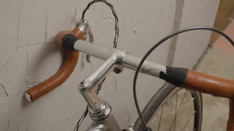

Brown wrapped chrome handlebars leaning against a light grey wall. Near the stem, a series of four small pins protrude from the bars to indicate a full battery charge of 100%.
[GRMNT] decided to bring his grandpa’s beautiful road bike into the future by making a sleeper e-bike conversion.
Going into the project, [GRMNT] didn’t really know what he was working with, but it turned out grandpa had good taste and was rocking a Bianchi. No stovepipe bike boom stuff here, only high quality Tange steel. After cleaning off the years of grime, it was time to rebuild a second-hand Bafang mid-drive electric motor for the electric boost for the ride.
We really like the custom solenoid-powered display that [GRMNT] built into the handlebars for an excellent electromechanical readout of the battery charge. Coupled with the hand-built battery pack inside a leather case and hidden motor actuation button, this build looks slick without screaming e-bike.

  5. The little tactile solenoid graph is indeed way cooler than any TFT or OLED could hope to be. Has a certain luxury watch feel to it.
    1. I’m a little concerned with the holes in the handlebars. I guess as a stress concentrator the cracks should start showing there first before failure though.
    1. My main gripe is him calling it a sleeper when the motor is plainly visible. Other than that, it’s a very good vintage e-bike conversion: I like the minimalist approach, use of leather, and the solenoid-based battery indicator is honestly a stroke of genius. That said, I have to wonder how well the entire setup performs in rainy conditions, which makes me wonder if this is more of a Youtube project than a “build for actual use” one.
