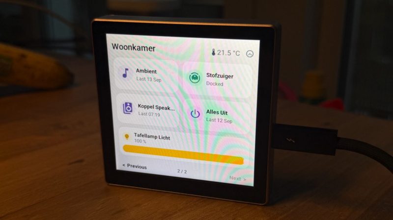

Home Assistant is a great way to rig up and manage your smart home and its many and varied devices. You can of course control the system from your smartphone or a computer, but you might like to have a dedicated interface too. In that regard, [Max Gramser]’s project may come in handy.

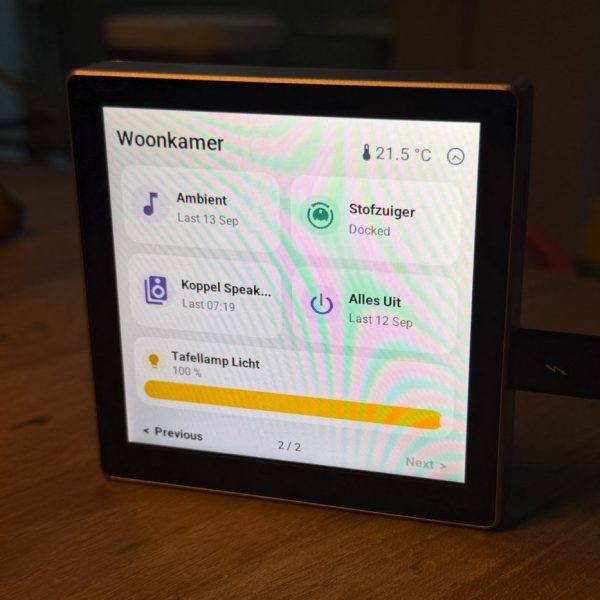

At heart, it’s a Home Assistant control screen that you can lay out yourself. It’s intended to run on ESP32 hardware. Most specifically, it’s built to run on the Cheap Yellow Display which combines an ILI9341 display with an XPT2046 resistive touchscreen, or a Guition ESP32-S3-4848S040, which has a ST7701S RGB display combined with a capacitive GT911 touchscreen. You merely need to load the firmware on to one of these units, and you’ll have a configurable and customizable touchscreen interface for your own Home Assistant setup.
The GUI used is clean, attractive, and flexible. You can have it display weather, time, and date widgets, populate the screen with buttons for activating lights and appliances, or even command a compatible robot vacuum. Whatever you might want to do with Home Assistant, you can almost certainly create a quick control for it on the display so it’s always on the wall, ready to go when you need it.
