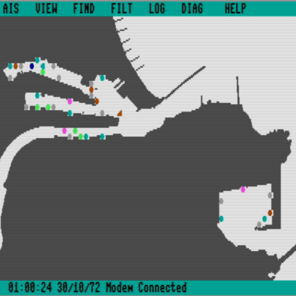

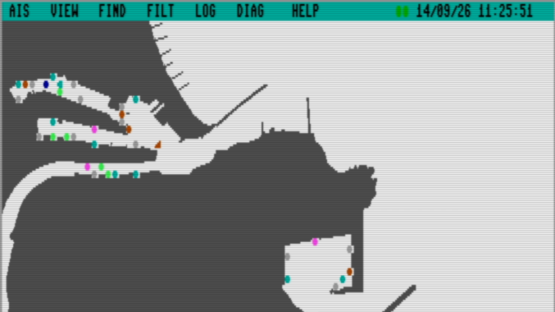

The Automatic Identification System (AIS) is a maritime radio communications tool used to allow different vessels to identify each other and communicate their movements and other telemetry. You can readily view a variety of AIS trackers online. Alternatively, you could build your own, and display the data on a retrocomputer from 40-plus years ago.
The concept is straightforward enough—it’s a Commodore 128 displaying vessel tracks from AIS data. The team behind AIS4CBM implemented this with assembly code to receive data over serial, parse and decode the AIS reports, and manage vessel data. Meanwhile, the front end is coded in BASIC 8, which provides useful graphic routines for plotting vessels on a map. There’s also a BASIC 7 text interface if you prefer to view the vessel data that way.
It’s worth noting that you can’t just run this on a barebones C128. AIS4CBM requires a 512 KiB REU RAM expansion, as well as 64 KiB VDC memory. You also need a SwiftLink compatible serial interface to get the data into the machine in the first place from your AIS receiver or other source. The project website notes that an Ultimate-II+ unit is a great way to fulfill most of these requirements with a single piece of hardware.
If you dig the project, you can check out a live stream from the C128 doing its thing below. We wouldn’t recommend a Commodore 128 if you’re a harbor master or otherwise commanding ships on the water. Still, it’s a fun project, and much like the NES that was set up to track planes with ADS-B data. Video after the break.
