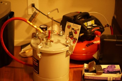

[thelostspore] was experimenting with resin casting, and discovered that he needed a pressure casting chamber in order to get clear casts. There are commercial solutions for sale, and they are really nice. However, many hackers are on a budget, and if you’re only casting every now and then you don’t need such a fancy set-up.
Re-purposing equipment like this is pretty common in the replica prop making community. Professional painters use a pressurized pot filled with paint to deliver to their spray guns. These pots can take 60-80 PSI and are built to live on a job site. By re-arranging some of the parts you can easily get a chamber that can hold 60 PSI for enough hours to successfully cast a part. Many import stores sell a cheap version, usually a bit smaller and with a sub-par gasket for around 80 US Dollars. [thelostspore] purchased one of these, removed the feed tube from lid and plugged the outlet. He then attached a quick release fitting to the inlet of the regulator.
Alternative pressure casting set-up.
We used this guide to build our own pressure casting set-up. Rather than plug up the outlet on ours, we put a ball valve with a muffler in its place to quickly and safely vent the chamber when the casting has set. We recommend putting a female quick connect coupling or another ball valve in combination with the male fitting (if your hose end is female). It is not super dangerous to do it the way the guide recommends, but this is safer, and you can disconnect the compressor from the tank without losing pressure.
All that was left was to test it. He poured an identical mold and it came out clear!

  6. I used these professionally for casting for about 7 years. That’s really all we do in production environments. Resins were poured and pressurized. Once the container reaches pressure,(30PSI is all you need ) you close the ball valve to the compressor. Had a second ball valve controlling the exhaust, which had mufflers that I built on them. For finely detailed work, I had a slightly more complicated set up that vacuumed the resin after pouring into the mold. There’s a trick to that that would take 1,000 more words than I would care to write to explain, but if you screw it up, you end up with foam. Do it right, and it takes out bubbles much better than pressure.
    Important to have an over pressure valve on your pot too. Don’t forget that.

    1. That won’t eliminate bubbles from many resins. 40 PSI is the minimum I’ve had success with on thicker resins like Crystal Clear 202.
      Running a pressure cooker anything above its label rating is an absolute nuh-uh hell no. Not even if you do add a pop-off valve. Look what they did at the Boston Marathon.
