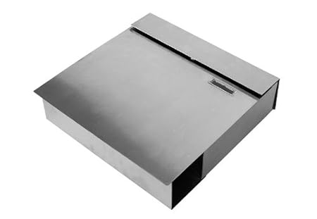

[Eric] hopes his work will help bring the truly expansive Home-Area-Network (HAN) into fruition by letting developers build cheap, battery-powered, long-range wireless sensors. His method integrates with the pluggable OSGI architecture and home automation platform openHAB along with using an Arduino as the lower power, sensor node that is capable of utilizing many types of cheap sensors found online.
[Eric]’s tutorial depicts a few examples of the possibilities of these open-source platforms. For instance, he shows what he calls a ‘Mailbox Sentinel’ which is a battery-powered mail monitoring device that uses a Raspberry Pi to play the infamous, and ancient AOL sound bite “you’ve got mail.” It will also send an email once the postman cometh.

  1. Good idea – but the “mail” sensor needs work. It doesn’t detect actual mail, just the mailbox door being open. The moment one of the more clever neighborhood kid discovers that, you’ll get around 9 bazillion false positives (or the whole sensor will mysteriously disappear).
    1. I thought about making a sensor like this as well, but since my mailbox does not open in any way for mail to get in i needed a sensor to actually detect something inside. I tried with IR transmitter + receiver which worked quite well. But today I would go for one of those proximity sensors that are found in phones for example. They can be setup to work independently and measure from time to time and generate an interrupt in case the readout is above a threshold (something reflective is inside). Of course you need quite a few of them because the mailbox is large.
      1. you could use a PIR sensor, they measure changes in IR over an area. They are commonly used in motion sensors for lights and such.
      2. Having only a traditional mailbox by the street, what do you means “does not open in any for mail to get in”?
        Back when Zigbee first came on the market, I built a sensor for my mailbox that would trigger a Zigbee message when the door was opened. Used a phototransistor to wake the unit. The module hung under the mailbox, and I had a small hole in the bottom for a photocell. When the door was opened, it was enough to trigger it. Used a Tadiran lithium battery (like used to be used in PCs) for the power source. Ran for years, then the receiver blew up, and I never got around to fixing it. For all I know, the mailbox is transmitting a message every day…

      Probably needs to spend a bit of time packaging it up, securing, and weather-proofing it a bit. Rain can still run down to the underside of that mailbox. Possibly an optical system to detect items.
