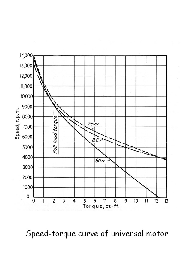

    Small brushed DC motors achieve their maximum output power at their rated voltage at half the maximum torque and half the rated speed. The torque decreses linearily with speed.
    http://m.eet.com/media/1178417/bldcfig5.jpg
    A typical design runs the motor above half the nominal speed because any increase in load is automatically met with increasing torque and power. The motor self-regulates. Below half-speed, an increase in power demand results in a stall. That also means you only have have half the rated torque available – at maximum – trying to design around that point will still stall the motor if the load increases for any reason.
