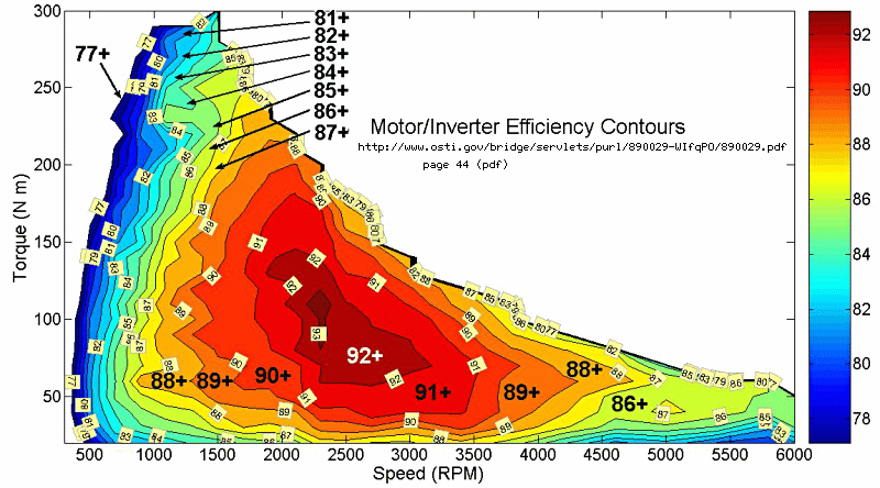

            3) Can you define sh1t efficiency? When I look around I see efficiency graphs showing close to 90 percent even in low speeds (10-20 mph). https://www.greenoptimistic.com/wp-content/uploads/2015/02/ornl-motor-efficiency.gif

            3) You’re misinterpreting the chart. The motor loses power at high RPM. Even though it can rev to 6000 RPM, you have to gear it to reach top speed much further down, say 3500 RPM, or it will never reach it.
            If 3500 RPM is your 100 mph, then going at 25 mph would put you somewhere below 1000 RPM, and looking up the graph to make some power (power is proportional to torque at fixed speed) to accelerate, the efficiency drops into the blue.

  10. Another big issue is dynamic range. The electric is best at it, with full torque from standstill, the Internal combustion engine has a wide range, say 1000 rpm to 5000 rpm, thats a 5 fold dynamic range, the turbine engine’s dynamic range is terrible, probably something like 1.5. A hybrid makes good sense, direct gear drive just means inefficiency and eating up your clutch.
    1. Murray, you must be thinking of a single shaft turbine – the Chrysler turbines were always dual shaft. The Chrysler turbine performed much like an electric motor – maximum torque was at stand still and decreased as your speed increased. The car I drove in 1963 (car this article is about) developed it’s maximum 425 lb-ft of torque at zero rpm!
      1. Surely that wasn’t at zero turbine RPM.
        That’s the point. You can always add a transmission in between – the trick is that with wide dynamic range motors, you don’t need any, and so the system becomes lighter and cheaper, and more reliable. The turbine runs from 30,0000 to 55,000 RPM which is a range of little less than 2, which means you need many many gears, or a CVT which isn’t exactly the best at handling torque.
        1. Dax, you missed the dual shaft. All Chrysler power turbines had a front shaft with the compressor on the front end and the turbine wheel on the inside of the case. That was separated from the power turbine which was connected to a 10 to 1 reduction gear. YES the power turbine was locked by the transmission (no torque converter) Chrysler had to modify the standard Torqueflite transmission so that in neutral the valves for forward and reverse were both active to lock the output turbine. Our car would idle at about 18,000 rpm – that is the compressor turbine – front of engine that kept the engine running. the Power turbine on a separate shaft behind the compressor turbine was stationary. Remove the shift lever on the automatic transmission from Neutral to Drive and the Power turbine would start to turn as you removed your foot from the brake and started to apply throttle. I was 16 years old at the time and one of the engineers took me aside and asked if I knew what “torque loading” was. I kind of sheepishly said – um yeah. He said like I told your dad last night – if you torque load for a rabbit start, watch the inlet temp don’t let it get above about 1400 degrees. That allowed the pressure to build against the power turbine so when you released the brake – you could burn rubber. There was a slight lag otherwise because of the fact you had to get the mass of the Power turbine turning from ZERO rpm. The Power turbine acted as a torque converter. Please read the engineering manual I have posted on my website – it shows everything you want to know about the 4th Generation turbine engine used in the 1963-65 Ghia program. – – http://www.turbinecar.com/images/engineer-bk.pdf – – is where it is located.
          Chrysler accumulated over 2 million miles of driving with the 50 car test fleet – those cars drove exactly like any other 1963 automobile. They had instant heat from the exhaust heat exchanger under the dash. The did not have Air Conditioning because of the need for the huge air cleaner to silence the turbine to a reasonable level – they deliberately left enough of the whine to alert the public to the unique car.
          I drove Jay’s car shortly after he got it. It had been 50 years since the last time I drove one of the Ghia cars – nothing changed from the driver’s seat – it was a plush four seat passenger car in 1965 when we had one for three months and it still is if you get a chance to see one running and driving.
          1. Jay Leno also has a gas turbine powered motorcycle. He wrote about it in Popular Mechanics. I remember the quote: “it’s like the hand of God pushing you along….”
          2. >”The Power turbine acted as a torque converter.”
            i.e. a transmission – albeit an integrated one.
            Now, going back to the original point, how efficient is such a transmission when it has to turn 30,000 RPM at the compressor turbine to 30 RPM at the wheels?
