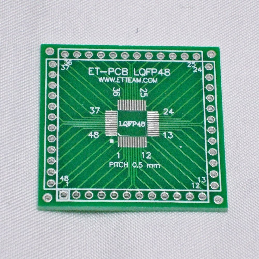

  10. Does anyone have any interest in splitting the shipping cost (to the US) to order some VS23S010D-L chips from VLSI? This does seem to be the biggest (cost) hurdle in building the BASIC Engine. The shipping cost seems to be about $40, regardless of how many chips you order from them. If interested, email me at dvanaria@gmail.com
        1. OK, I went looking for them.
          I have 7 chips marked VS23S010D and not “VS23S010D-L” as you refer to. I can’t find any package marking specification for these chips. I am left to assume that the “-L” is an order code for “tray” and “-S” is an order code for “tube” rather than being an actual package marking.
          I can spare two or three.
          They are LQFP-48 @ 0.4mm.
          Postage from here is AUD$3 for a letter and AUD$17 for a parcel with 6 working day transit.
          The chips probably wont make it there by themselves in an envelope.
          I have breakouts that are about an inch square that I can put them on for protection –
