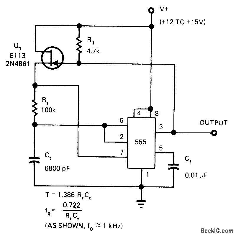

          http://www.eeeguide.com/wp-content/uploads/2016/09/Timer-IC-555-7.jpg
          A 555 is basically a set-reset latch where the set input has a logic treshold at 2/3 the Vcc, and the reset input at 1/3 Vcc. You can change these limits by inserting a voltage into the control pin. The rest is up to your imagination.
