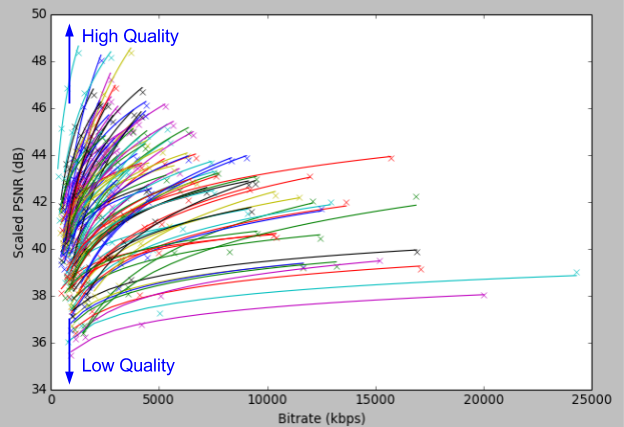

At that time, Netflix was using PSNR (Peak Signal-To-Noise Ratio) in dB as a measure of picture quality. They figured out that this fixed bitrate ladder is more an average or rule of thumb for most content, but there are several cases where is doesn’t apply. Scenes with high camera noise or film grain noise, a 5800 kbps stream would still exhibit blockiness in the noisy areas. On the other end, for simple content like cartoons, 5800 kbps is an overkill to produce 1080p video. So they tried different parameters for each title:
Image for post
Each line here represents a title, a movie or an episode. Higher PSNR means better overall image quality: 45 dB is very good quality, 35 dB will show encoding artifacts. It’s clear that many titles don’t actually gain a lot from increasing the bitrate beyond a certain point. In general, per-title encoding will often give you better video quality, a either higher resolution for the same bitrate or same resolution for less bitrate.
Title contents can be very different in nature. But even within the same title, there can also be  high action scenes and later a still landscape. That’s why that when Netflix decided to chunk-encode their titles to take advantage of the cloud, by splitting the movie into chucks so it could be encoded in parallel, they started to test and implement Per-Chunk Encoding Optimization in 2016. It’s the same logic as per title, but for each chunk in the title. It’s like adding one more level of optimization.
