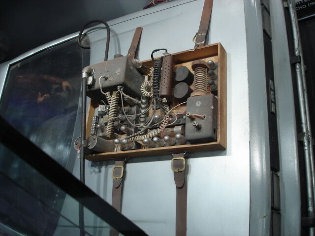

https://static.wikia.nocookie.net/bttf/images/0/04/TimeControlTubesModel.jpg/revision/latest/scale-to-width-down/640?cb=20080802225029
https://backtothefuture.fandom.com/wiki/DeLorean_time_machine?file=TimeControlTubesModel.jpg
This link
I’m really curious what it’s based on! I wonder if it’s a modified tube radio for some movie magic?
