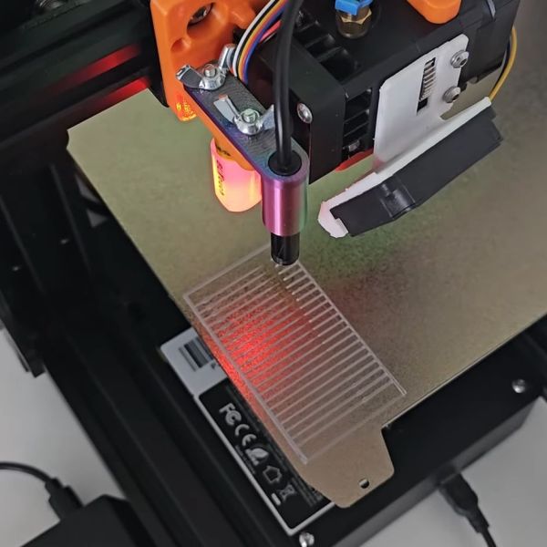

To automate his pressure advance calibration process, [Marius Wachtler] attached one of those dirt-cheap endoscope cameras to the print head of his modified Ender 3, pointing straight down and square with the bed. A test grid is printed in a corner of the bed, with each arm printed using a slightly different pressure advance setting. The camera takes a photo of the pattern, which is processed by computer vision to remove the background and measure the thickness of each line. The line with the least variation wins, and the pressure advance setting used to print that line is used for the rest of the print — no blubs, no blebs.

Sounds like a regular photo would work fine for analysis. I see no need for the endoscope camera… for this anyway.
Direct Drive Extrusion might reduce the problem.
yeah that was exactly my thought…like, this method seems a lot like a ‘temperature tower’. no one uses a camera mounted on their printer for that, they just print the object and then hold it in their hands and eyeball it.
i know the kind of defects i had from pressure variability in a bowden extruder were absolutely not subtle…i definitely could evaluate it just eyeballing spaghetti traces on the build plate.
Yes but the key is that this is executed automatically at the start of every print (if you like) so it’s does it automatically without human input. Just like auto bed leveling or so…
Exactly. That it’s “easy” to eyeball is more reason to automate it away. When you run printers 24/7, the manual calibration processes add up, regardless of whether you’re running an Ender or a Voron. Automation reduces wasted time and improves reliability as the calibration and adjustments can be executed more proactively. Even BambuLab printers need some of these manual steps. At least with OSS firmware you can automate them away and spend your time on more productive things. Thank you for your work on this and for improving what OSS printers can do. This is what pushes the industry forward.
Cool thing is they are using fal.ai to provide access to the BiRefNet model, but there is no reason you couldn’t run it locally (provided you have a suitable gpu/platform for it)
https://github.com/ZhengPeng7/BiRefNet
yes I’m using this open model. In the video when I talk about running locally I was thinking about running it directly on the printer itself where the hardware constraints are lower… But I hope that a model like https://github.com/xuebinqin/DIS this can work if trained for this task and can be run on the printer itself…
Very nice! I’d love to set this up on my ender. Adding klipper’s pressure advance was a huge upgrade from stock, plus the other upgrades many of us have. I’m down to add a $3 endoscope for automated pressure advance!
Cool, let me know if you run into any issues or questions come up.
This looked like an amazingly smart idea, until I considered that pressure advance really isn’t hard to do quickly by eye. You have to remove the calibration lines by hand anyways, so you might as well just look down and take the 30 seconds to get a ‘close enough’ calibration factor without all this camera mess. I don’t even use it on my K1 Max, it really makes little difference and it’s usually just 0.04. Simply having it turned on and set to a general number makes the most difference.
The way I have set it up right now is that this runs, just like bed leveling, automatically at the beginning of the print. So you will loose a bit of build volume if you do it like this but you don’t have todo anything manually it will just continue with your print. And you remove the test pattern and the print at the end when everything is finished.
