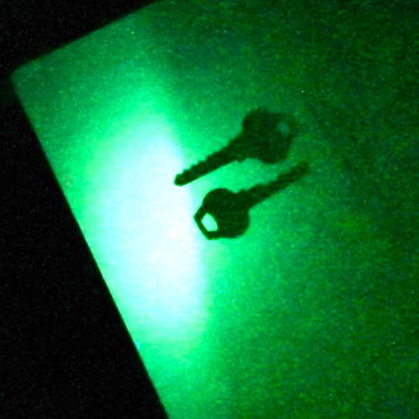

Perhaps not, as these experiments with an overdriven magnetron suggest. First off, this is really something you shouldn’t try; aside from the obvious hazards that attend any attempt to generate ionizing radiation, there are risks aplenty here. First of all, modifying magnetrons as [SciTubeHD] did here is risky thanks to the toxic beryllium they contain, and the power supply he used, which features a DIY flyback transformer we recently featured, generates potentially dangerous voltages. You’ve been warned.
For the experiment, [SciTubeHD] stripped the magnets off a magnetron and connected his 40-kV AC power supply between the filament and the metal case of the tube. We’re not completely clear to us how this creates X-rays, but it appears to do so given the distinctive glow given off by an intensifying screen harvested from an old medical X-ray film cassette. The light is faint, but there’s enough to see the shadows of metallic objects like keys and PCBs positioned between the tube and the intensifying screen.

  5. “We’re not completely clear to us how this creates X-rays”
    It’s breaking radiation, or if you like technical jargon and/or German, bremsstrahlung. Without the magnet, you’ve got electrons slamming full force (40 keV) straight into the wall of the magnetron. There, they stop. In stopping, they give off X-rays.
    (Electromagnetic waves happen whenever you have big accelerations on a charged particle. You can derive the formula for it from Maxwell’s laws but it’s easier just to think of it as a whip-crack going through the electromagnetic field around the particle.)
    All x-ray tubes work like this; the bigger ones use actively cooled tungsten targets, since as you might imagine, not all of the energy of the electron beam ends up in x-rays. It would be interesting to know how hot the target spot of on the magnetron gets. Hopefully he doesn’t run it for very long, regardless.
    1. That’s braking radiation. The electron energy gets converted to electromagnetic wave when the electron is decelerated (braked), not when it gets broken on impact.

  6. He removed the magnets from the magnetron, so it’s no longer really a magnetron but a vacuum tube. The magnets would normally let the electrons circle inside the vacuum. Accelerated electrons emit radiation, and going in circles is a constant acceleration. The speed of the electrons (determined by the applied voltage) as well as the strength of the magnetic field determine the wavelength/frequency, which would be in the GHz range.
    Now without the magnets, the electrons are just going straight until they hit the wall of the tube. If you apply 40kV, they will gain an energy of 40keV (kilo-electron-volts), which is in the low relativistic regime (511keV/c is the mass of an electron, so it’s a bit below 10%). When they hit dense matter (the wall), they will be decelerated rather quickly – which again produces radiation. This is exactly the same way as an X-ray tube produces X-rays. The wavelength depends on the energy of the electrons and the material (how fast it stops the electrons).
