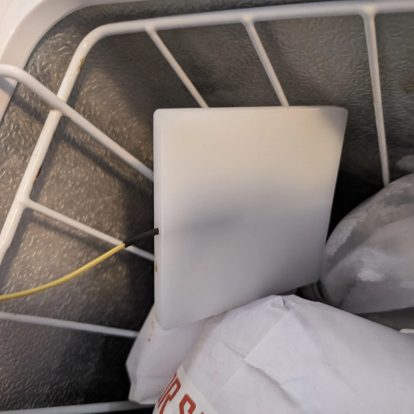

A lot of projects we see around here are built not just because they can be built, but because there’s no other option available. Necessity is the mother of invention, as they say. And for [Jeff] who has many thousands of dollars of food stowed in a chest freezer, his need for something to keep track of his freezer’s status was greater than any commercial offering available. Not only are freezers hard on batteries, they’re hard on WiFi signals as well, so [Jeff] built his own temperature monitor to solve both of these issues.
The obvious solution here is to have a temperature probe that can be fished through the freezer in some way, allowing the microcontroller, battery, and wireless module to operate outside of the harsh environment. [Jeff] is using K-type thermocouples here, wired through the back of the freezer. This one also is built into a block of material which allows him to get more diffuse temperature readings than a standard probe would provide. He’s also solving some other problems with commercially available probes here as well, as many of them require an Internet connection or store data in a cloud. To make sure everything stays local, he’s tying this in to a Home Assistant setup which also allows him to easily make temperature calibrations as well as notify him if anything happens to the freezer.
Although the build is very robust (or, as [Jeff] himself argues, overengineered) he does note that since he built it there have been some additional products offered for sale that fit this niche application. But even so, we always appreciate the customized DIY solution that avoids things like proprietary software, subscriptions, or cloud services. We also appreciate freezers themselves; one of our favorites was this restoration of a freezer with a $700,000 price tag.

  2. I used to have an ESP8266 with ESPEasy and two OneWire probes monitoring my fridge/freezer combination. Reporting to Domoticz, which handled alerts. Problem is the wires making a small gap in the door seals letting warmer air in, which in the freezer also caused frozen condensation. Decommissioned now.

      2. If you’re using a thermocouple, this is a bad idea – each dissimilar metal joint creates another thermocouple pair, which will cause errors in the sensed voltage and throw off your measurements. You can get really thin-wire thermocouples (like less than .020″ dia) that will let the gasket close pretty much completely.

  5. I’ve been thinking that a flexPCB would be a perfect solution to get a sensor inside the freezer, without leaving a big gap around the wires for thermal losses. Only question is then how to have the sensor stick to the inside of the freezer. Feels like a job for a magnet, although the inner skin is probably plastic …

  11. Regarding running temperature sensor wires out the door seal… Do NOT run them through the interface of the door and the seal as it does what others have mentioned and can create a path for air. Instead, run the wires UNDER the door seal where it is bonding to the fridge/freezer. If any gap is created, just put a dab of silicone to seal it. Since you are not passing through the interface, you can glue it in place. The flexible seal between the seal and door is fully maintained.
