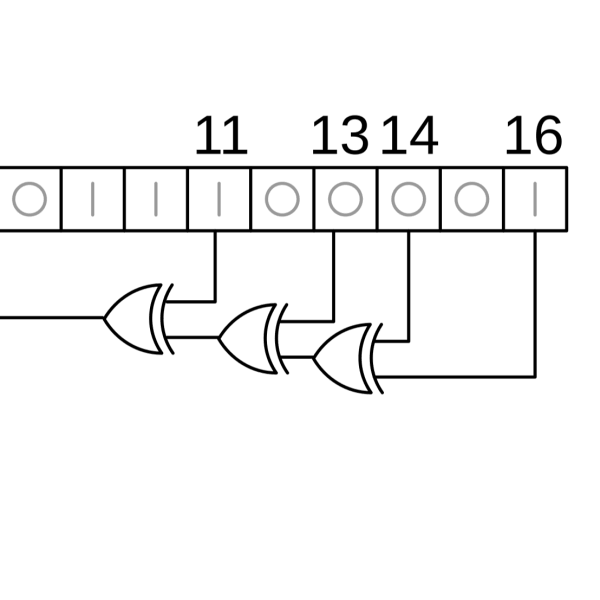

Circuit diagram of linear-feedback shift register.
Today we heard from [Richard James Howe] about his new CPU. This new 16-bit CPU is implemented in VHDL for an FPGA.
The really cool thing about this CPU is that it eschews the typical program counter (PC) and replaces it with a linear-feedback shift register (LFSR). Apparently an LFSR can be implemented in hardware with fewer transistors than are required by an adder.
Usually the program counter in your CPU increments by one, each time indicating the location of the next instruction to fetch and execute. When you replace your program counter with an LFSR it still does the same thing, indicating the next instruction to fetch and execute, but now those instructions are scattered pseudo-randomly throughout your address space!
When the instructions for your program are distributed pseudo-randomly throughout your address space you find yourself in need of a special compiler which can arrange for this to work, and that’s what this is for.

  1. Seems fairly straightforward. An LFSR will follow a predictable series of states in a loop, just like a counter will, and if the loop is large enough it becomes equivalent to a fairly usefully-large counter. Then you just need to develop a mapping between what would be 0,1,2,etc for the counter to the states of the LFSR. So long as this massive lookup table can fit in ram (or you can find another way to do the conversion quickly enough) then it becomes fairly straightforward to convert a program using regular ordered addresses to this new mapping where they become scattered around the address space.
    1. I think you could have a hard time computing this lookup in reasonable time on the system using the LFSR though. Going to need a much larger computer with enough ram to hold the mapping for the entire effective address space for the LFSR computer, unless you fancy doing a lot of traversals of the LFSR’s chain of states in simulation during compile.

        1. how would the upper bits know when to increment? An 8 bit lfsr has a period of 255, so you would somehow need a mechanism to only clock the upper lfsr every 255th cycle (which is even harder than the carry that normally accomplishes this in a regular PC).
          Also as I alluded to, since the period of an LFSR is 2^n -1, (since the all 0 state is impossible), tying together multiple 8 bit lfsrs makes more and more invalid states where instructions cannot go. At 32 bit a full 64MB of memory would be inaccessible to the program counter (although it could potentially be used for the LD/ST subsystem)

  8. If you really need to reduce the number of gates used, some register lengths allow for just 2 bits, a single XOR gate, to create a max length LFSR.
    Adding a single inverter can make all zeros a valid state. Either place it at the output of the XORs to invert the feedback bit, or put it on the most-significant output bit. In either case, all 1s becomes the invalid state.
    When you’re using 74-TTL you have to clock some 1s into the shift register at startup. With inverted feedback, just hit the chip’s reset pin to get a valid (all 0s) starting state.
