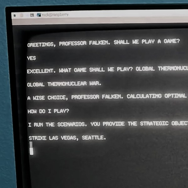

Closeup of WOPR interface on Raspberry Pi
WarGames fans, rejoice: [Nick Bild] has rebooted WOPR for real. In his latest hack, the Falcon, he recreates the iconic AI from the 1983 film using a Raspberry Pi 400, a vintage SP0256-AL2 speech chip from General Instrument, and Google’s Gemini LLM. A build to bring us back to the Reagan-era.
Where most stop at visual homage, this one simulates true interaction. The Python script acts as dungeon master for Gemini 2.5 Flash, guiding it to roleplay as the WOPR computer. Keypress sounds click-clack in synchrony with every input. Gemini replies are filtered into allophones, through GI-Pi, [Nick]’s own Python library. The SP0256 then gives it an eerily authentic robotic voice, straight out of 1983.
