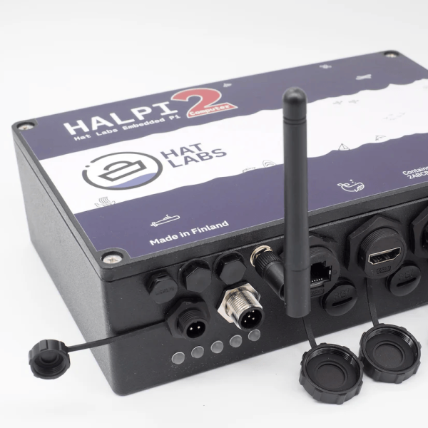

A black, rectangular box is shown, with a number of waterproof screw connectors on the front.
Nautical navigation has a long history of innovation, from the compass and chronometer to today’s computer-driven autopilot systems. That said, the poor compatibility of electronics with saltwater has consequently created a need for rugged, waterproof computers, a category to which [Matti Airas] of Hat Labs has contributed with the open-source HALPI2.
Powered by the Raspberry Pi Compute Module 5, the electronics are housed in a heavy duty enclosure made of aluminium, which also serves as a heat sink, and closes with a waterproof seal. It has a wide variety of external connectors, all likewise waterproofed: power, HDMI, NMEA 2000 and NMEA 0183, Ethernet, two USB 3.0 ports, and an external WiFi or Bluetooth antenna. The external ports are plugged into the carrier board by short extension cables, and there are even more ports on the carrier board, including two HDMI connectors, two MIPI connectors, four USB ports, and a full GPIO header. The case has plugs to install additional PG7 or SP13 waterproof connectors, so if the existing external connectors aren’t enough, you can add your own.
Besides physical ruggedness, the design is also resistant to electrical damage. It can run on power in the 10-32 volt range, and is protected by a fuse. A supercapacitor bank preserves operation during a power glitch, and if the outage lasts for more than five seconds, can keep the system powered for 30-60 seconds while the operating system shuts down safely. The HALPI2 can also accept power over NMEA 2000, in which case it has the option to limit current draw to 0.9 amps.

  1. So,
    What happens to the Ethernet, USB and HDMI connections once their made up?
    I spent a goodly parts of my professional life putting electronics in less than hospitable conditions.
    These connects are going to have a very short life in a marine environment.

        Put some real waterproof connectors on this thing. Even they will fail, but not anywhere near a often as there’s open to the site connections.
        1. Ethernet, usb and hdmi are used all over the place on boats and they last just fine. Every modern chart plotter and display uses these connections.

    1. If those caps for the connector are waterproof (or even just splash proof) those connectors won’t get exposed to the air/water mix in normal use, as they are covered. And go one better you just drill a hole in them and use a rubber grommet or print/over mould one with a print onto your cable so they are similarly very well protected while populated. With the added bonus it will hold the non latching connectors in place so they can’t fall out too…
      I’d expect them to have pretty good lifespan.
    2. You can get HDMI and USB overmolded connnectors that will screw into the connectors on the box to provide a water proof seal around the actual connection. But like others have said. This equipment would be mounted in the protected cabin anyway, so it’s mostly a non-issue.

      1. I usually put a coat of dielectric grease on connections that are exposed to the elements if they’re not going to be unplugged often. Sure it can be messy, but it’s easier to wipe off than replace a rusty connctor.
      2. The article doesn’t mention it but I would assume that the connectors are all marine (salt air) rated, which also drives the price up.
        I have been using a Pi Zero on my sailboat for some time and rusting USB connectors have been a problem.

  4. Galvanic corrosion will quickly mess up the aluminum enclosure around the bulkhead connectors made of brass.
    SMA connectors are not a good choice either.
