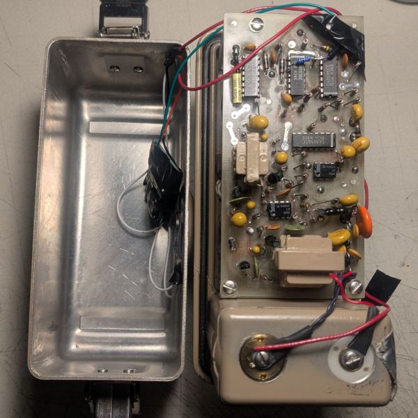

While we often get a detailed backstory of the projects we cover here at Hackaday, sometimes the genesis of a build is a bit of a mystery. Take [maurycyz]’s radiation survey meter modifications, for instance; we’re not sure why such a thing is needed, but we’re pretty glad we stumbled across it.
To be fair, [maurycyz] does give us a hint of what’s going on here by choosing the classic Ludlum Model 3 to modify. Built like a battleship, these meters would be great for field prospecting except that the standard G-M tube isn’t sensitive to gamma rays, the only kind of radiation likely not to be attenuated by soil. A better choice is a scintillation tube, but those greatly increase the background readings, making it hard to tease a signal from the noise.
To get around this problem and make rockhounding a little more enjoyable, [maurycyz] added a little digital magic to the mostly analog Ludlum. An AVR128 microcontroller taps into the stream of events the meter measures via the scintillation tube, and a little code subtracts the background radiation from the current count rate, translating the difference into an audible tone. This keeps [maurycyz]’s eyes on the rocks rather than on the meter needle, and makes it easier to find weakly radioactive or deeply buried specimens.
