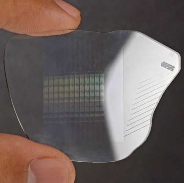

The geometric waveguide glass of the Meta Ray-Ban Display glasses. (Credit iFixit)

Overall, these smart glasses can be considered to be somewhat repairable, as you can pry the arms open with a bit of heat. Inside you’ll find the 960 mWh battery and a handful of PCBs, but finding spare parts for anything beyond perhaps the battery will be a challenge. The front part of the glasses contain the antennae and the special lens on the right side that works with the liquid crystal on silicon (LCoS) projector to reflect the image back to your eye.
While LCoS has been used for many years already, including Google Glass, it’s the glass that provides the biggest technological advancement. Instead of the typical diffractive waveguide it uses a geometric reflective waveguide made by Schott, with the technology developed by Lumus for use in augmented reality (AR) applications. This is supposed to offer better optical efficiency, as well as less light leakage into or out of the waveguide.

  5. Too bad that they chose to go with one of the weakest of Lumus waveguide offerings. Ive got a Lenovo A6 running their top down 1920X1080 Vision waveguide with 40 degree FOV but I would love if some company would push a product out with this form factor using the 50 degree fov 1440×1440 side feeding Lumus Maximus or the 1024×1024 Zlens. Either would have been a better more useful choice than what they went with.

    1. Lumus/Schott has the ability to produce prescription adjusted waveguides but to date none of their manufacturing partners are offering a product that takes advantage of this ability.
