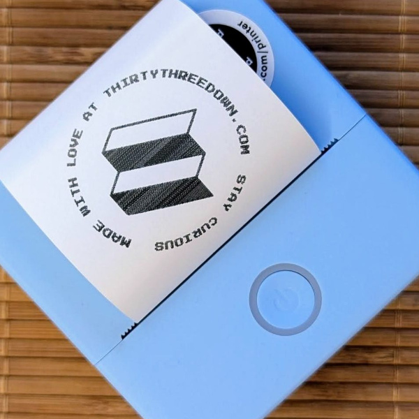

The arrival of cheap thermal printer mechanisms over the last few years has led to a burst of printer hacking in our community, and we’re sure many of you will like us have one knocking around somewhere. There are a variety of different models on the market, and since they often appear in discount stores we frequently see new ones requiring their own reverse engineering effort. [Mel] has done some work on just such a model, the Core Innovation CTP-500, which can be found at Walmart.
The write-up is a tale of Bluetooth reverse engineering as much as it is one about the device itself, as he sniffs the protocol it uses, and finds inspiration from the work of others on similar peripherals. The resulting Python app can be found in his GitHub repository, and includes a TK GUI for ease of use. We like this work and since there’s an analogous printer from a European store sitting on the Hackaday bench as we write this, it’s likely we’ll be giving it a very close look.

There are many such BLE thermal printers, a good number supported by my Thermal_Printer library (https://github.com/bitbank2/Thermal_Printer). I’m not sure why this particular model is noteworthy – it costs more at Walmart than many products with the same physical characteristics available from other vendors.
Hi Larry, Mel here! Going over my notes I can see that the Thermal_Printer library repository is in there, but it looks like I didn’t use it. Maybe I tested it and it didn’t work for some reason? Regardless, no doubt I learned a lot just from reading the notes in the repository. Thanks for putting this library back on my radar!
Hi Larry! Going through my notes I can see your Thermal_Printer library repository is in there. I don’t think I used it in the end – I think maybe I failed to get the printer to connect? – but looking at the code and your notes surely helped me think my way around this project. Thanks for putting it out there!
There’s nothing noteworthy about this device aside from being available at Walmart! And you’re right re. price, which is why I bought it off Amazon since my local store couldn’t price-match for me. Ultimately, I wanted to make something that would help people who just buy stuff from Walmart make the most of their little printer. If it helps at least one other person, I’m a happy camper!

There’s a new kid on the block that supports a slew of similar thermal printers besides the CTP500:
https://github.com/Dejniel/TiMini-Print
I’m not exactly a kid :P But… TiMini-Print fully supports the entire CTP-500 printer family, even though “CTP-500” is a commercial product name rather than the Bluetooth device name ;) And, for SEO, the Bluetooth device names are: CorePrint, Teal Printer, Purple Printer, B Pink Printer, Cherry Printer, Floral Printer, Check Printer, Smiley Printer, Stone Printer, P Pink Printer, and YHK
