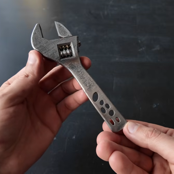

Consumer-grade 3D printing is good for prototyping and making relatively soft plastic stuff. If you wanna make tough things, though, it’s really hard to beat the strength of metal. [Shake the Future] has produced a guide on using 3D printing in a process to produce solid parts out of actual cast iron.
The concept is simple. [Shake the Future] uses silicon carbide crucibles, which can heat up by absorbing microwave energy. Put one in an insulated container, dump some metal in, and throw it in a microwave, and soon enough you have a pot of molten metal you can use to cast stuff.
Let’s say you want to make an adjustable wrench, which is how [Shake the Future] demonstrates this technique. The first step is to print the wrench parts in plastic, such as PLA. These parts are then packed into fine sand to create casting molds. The PLA is burned out of the mold, leaving a negative imprint of the geometry. Molten cast iron can then be poured into the mold to create the part in solid metal.
It’s a messy technique that requires a lot of manual labor, but it does work quite well. There are some tricks to learn, though, particularly when it comes to successfully casting parts with holes or fine geometric features.
And before you think that you’re going to put the hardware store out of business, it should also be noted that it failed on first encounter with a real-world nut. The thinnest part by the screw just wasn’t strong enough.
Still, it’s a great demo, and if you’ve ever wanted to make a bespoke cast iron part of your own, this work may be very relevant to you. Alternatively, consider learning about DIY aluminium casting—just consider the pitfalls involved.

          1. This is an exercise in stupidity in my opinion..the grain strength is abysmal in the cast part…the saving grace is the unique method of melting the cast iron which is way different than the way it’s usually done..these parts are usually forged in the real world and for good reason..

    1. It takes a lot of pressure to fill thin wall structures like those found in model kits. Certainly not something you can sand cast and direct pour. It would require extensive gating, ventlines, investment casting, and centrifugal casting.
      1. How thin? I cast a wedding ring in silver and the band was less than 1/16″. Also fine details and 3d print layer lines even showed up. Gating and vent lines took less time to make than it took to type this.
        1. The plastic walls of a typical 1/24 or 1/25 scale plastic model car kit (styrene) generally measure between 0.020 and 0.040 inches (roughly 0.5mm to 1mm) in thickness. Quite a bit thinner than your wedding ring. Metal flowing into these thin channels solidifies faster than it can fill unless it is being introduced with significant pressure. Die casting Zinc alloy toy cars typically requires 15-30KPsi to fill the molds.
