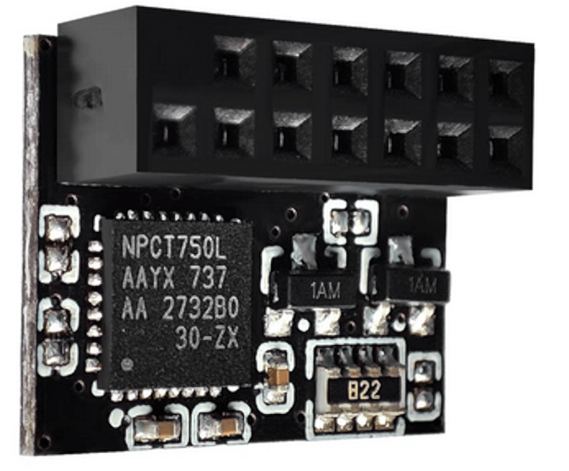

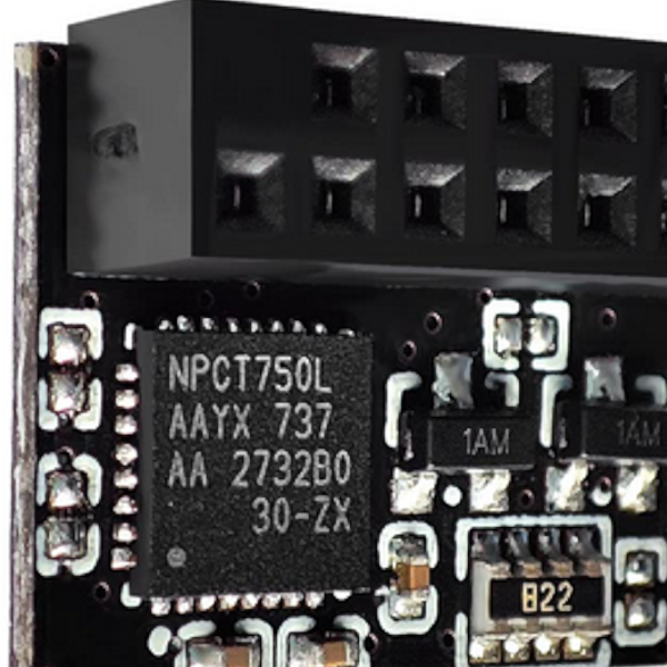

  3. The TPM in the image is from Nuvoton, a Taiwanese company.
    I’ve used TPMs (in boards of my own design) from STMicroelectronics, a European company. Those TPMs were designed in India.
    Companies such as Microchip design and make TPMs in USA.
