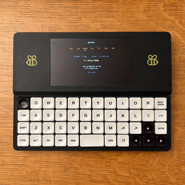

So the answer lies in a sort of journalistic deposit box. That’s basically what we have here. [Simon Shimel]’s Bee Write Back writerdeck was inspired by sleepless nights, so you know it’s effective. The form factor is so great for [Simon], in fact, that he has developed more apps and functions for it, including a Claude client.
Inside is a Raspberry Pi Zero 2w, and input comes from an Air40 keyboard with quite awesome low-profile key caps. The display is a 5.5″ AMOLED, which leaves just enough room for a pair of the cutest bees ever. Be sure to check out the short video below for the build guide to accompany the build guide (PDF), and head over to GitHub for the full details.

  2. Very accurate and professional 3D Printing, almost as good as injection molding. Very nice build. Was expecting to see the guy soldering the 48 key-switches on, but even that was just press-fit.

      Thoughts on the form factor: I suppose one thing it has going for it is simplicity, it should be fairly robust. Personally I’d prefer a clamshell design, but that’s because I’d want to carry it around and not destroy the screen, I’m sure the creator has identified their needs and doesn’t intend to carry their deck around.
    2. Yeah you put your finger on why this sort of hack always upsets me. Personally, i’m not sure about the form factor…depends on your habits, i suppose, whether you use it in bed or at a desk or whatever. Hard for me to put myself in the shoes of someone using a flat keyboard-tablet like this.
      But i know there’s no one in the world who, in 2026, says, “the market has so many great options, but if only there was one that didn’t have suspend-to-RAM / instant-resume”. No one who is trying to meet their own needs wants to suffer a boot process every time they are inspired to record a few words. The raspberry pi is completely unsuited for this task. RP2040 Pico, ESP32, etc, these are great for this task, if writing is really what you want. But raspberry pi is all downside.
