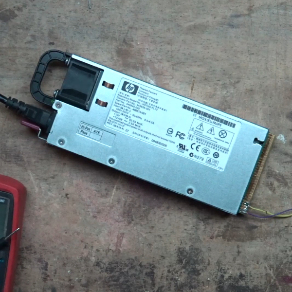

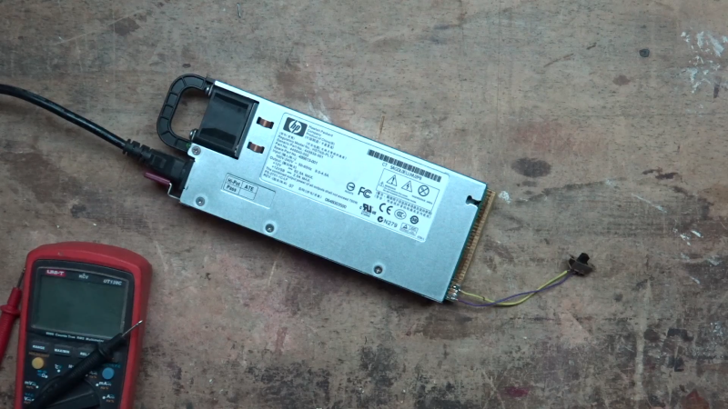

Most makers find themselves in need of a benchtop power supply at some point or another. Basic models can be had relatively cheaply, but as your current demands go higher, so does the price. [Danilo Larizza] has figured out an alternative solution—repurposing old server hardware to do the job instead.
The build is based around an HP Common Slot (CS) server power supply. They can be readily had for well under $50 if you know where to look. Even better, they can deliver over 50 amps at 12 volts, which happens to be a very useful voltage indeed. All you need to do is some minor mods.
A jumper on a couple of pins will get the power supply running, and with the addition of some terminals for your hook-up leads, you’re ready to go. As a hot-swappable single unit, the power supply is already outfitted with a ventilation fan to keep everything cool. If so desired, you can even make some further mods to bump output voltage a little ways past 13 or 14 volts if you’d like to use them for certain battery charging tasks.
Sure, you’re not getting a variable power supply, but if you need 12 volts and lots of it, this is a great way to go. We’ve featured similar builds before, too, turning ATX PC power supplies into useful benchtop tools.

  1. Server PSU’s tend to be quite loud. Changing Fans to get them silent is mostly not an option because they check rpm and unless it is an exact match the power supply will turn off in a fail mode.
    Laptop Bricks on the other hand mostly get you 6 – 10 Amps of 19 Volts (moddable to 12 or 13.8 if you want) Without making any noise at all. They can be had for a similar price.
    1. Those platinum ones with 94% efficiency are said to be mostly silent when you draw about 60% rated wattage, so if you need 400W get 750W one (HSTS-PL/PD29), see discussion here https://www.reddit.com/r/EtherMining/comments/pdug7c/hp_power_supplies_running_silent_on_66_load/
      I cannot confirm myself yet but I just researched this topic too and few days ago ordered PL28 (460W) for BC-250 which draws about 220W and hope it will be silent too. some videos on youtube confirm this too like the guy here https://youtu.be/NndDN4fpq64?t=475
    2. I have used one before as a basic power supply, it was not loud at all, given I wasn’t drawing much current from it.
    3. I would think many people on HaD can make or acquire a little pulse generator to feed the fan connector with whatever frequency that tickles it.

  3. I fished a variety of PSU’s including some of these pout of some old servers a while ago – the hobby RC community have hacked various models to give them fast charging for their battery packs so the info is out there.
    I’ve yet to find a fan speed control pin though – I’m sure some of them just run full speed all the time but I reckon at least a couple of models must be able to throttle down for quiet operation.
    I use one of mine to run big 12v loads in the workshop – old 12v battery drills can be had for free, if you’re got a 50A 12v PSU handy you’ve got a good quality drill that will run all day.

    1. There are adapters that have the edge connector and break out all the cables to heavy gauge wire. I have a bunch of the HP’s that produce 200A with 220V input (100A I think with the 120V). I got them for some experiments 15 years ago. And some Bitcoin mining I should have stuck with! Much as I thought I wold find them very useful, I have not used them since. ……. Checking eBay the adapters have dropped way down in price. In fact $10 for one with 12 of the 6 pin connectors! Example https://www.ebay.com/itm/234438388098 and interesting, the PSU’s are now $15 to $20. I wonder how well they handle 12V stepper motor loads.

    2. You can get boards for them that were for crypto mining so they have connectors on them for GPUs. Make sure that your grounds are the same and you will probably be fine, just like when using multiple ATX power supplies.
