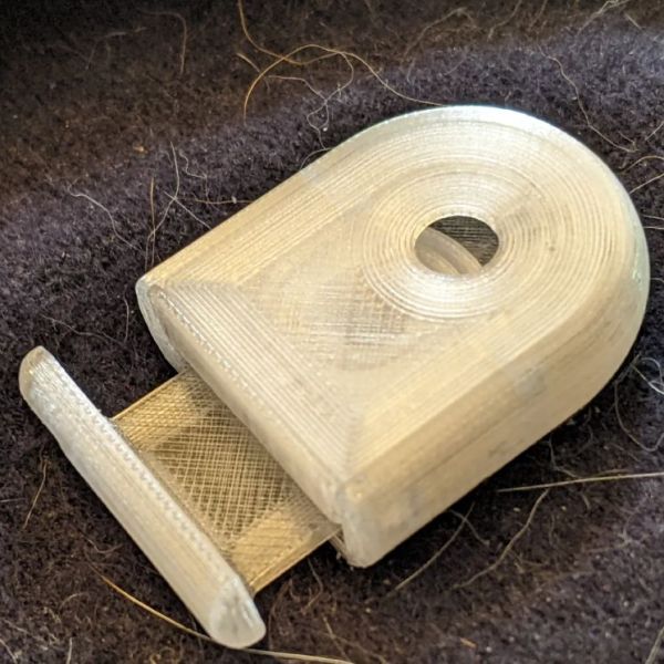

Springs are great, but making them out of plastic tends to come with some downsides, for fairly obvious reasons. Creating a compliant mechanism that can be 3D printed and yet which doesn’t permanently deform or wear out after a few uses is therefore a bit of a struggle. The compliant toggle mechanism that [neotoy] designed is said to have addressed those issues, with the model available on Printables for anyone to give a shake.
The model in question is a toggle, which is the commonly seen plastic or metal device that clamps down on e.g. rope or cord and requires you to push on it to have it release said clamping force. Normally these use a metal spring inside, but this version is fully 3D printable and thus forms a practical way to test this particular compliant mechanism with a variety of materials.
The internal spring is a printed spiral spring, with the example in the video printed in PETG. You can of course also print it in other materials for different durability and springiness properties. As noted in the video, PLA makes for a very poor spring material, so you probably want to skip that one.

    1. Someone with more material knowledge then me once told me that plastic always permanently deforms under tension, no exceptions, you can slow it, but never prevent it. Metal does not have this issue (they need some minimal deformation before they permanently can deform) which is why springs are generally made out of that.
      1. There are (at least) two different phenomena going on: elastic deformation vs plastic deformation: the range of stress where the material returns to its original shape when the stress is removed, vs the range where the deformation is permanent, and some plastics have a decent elastic deformation range; and also creep, which is what happens when a material is under stress for an extended period, and that’s where plastics really are pretty terrible. To be fair, lots of metals also creep, and everything does when it gets hot enough. Jet engine design is primarily driven by trying to figure out how to keep ultra high melting point metals from creeping too fast.

    If i’m going to call a compliant plastic mechanism ‘reliable’, i’m going to have to see at least a couple years’ lifetime out of it. Pretty confident that even after 6 months, you would feel like this plastic has crept like crazy and lost most of its springiness. In fact, i think we’ve had that article before. “You can’t make springs out of plastic” is a pretty worthwhile observation in my book.
    But if you’re doing the work “for the clicks”, then why would you wait years after doing the work in order to start harvesting the clicks? And so we get a result that is clickable but has no other features.
    1. Yeah, I’d assume a spring would need to be made of a material with a fatigue limit and no tendency to creep. Anything less would just be something that looks like a spring.

    Many years ago I saw some actual fatigue test data on a bunch of solid or injection moulded plastics, and it was scary. My takeaway was that at very best, fatigue limit at 10^6 cycles was 10% of initial strength. FDM could only make performance worse.
    Sure this thing won’t do anywhere near that many cycles, but once you account for creep, none of these will be functional in 6 months. Whereas the 1c steel spring will last forever.
