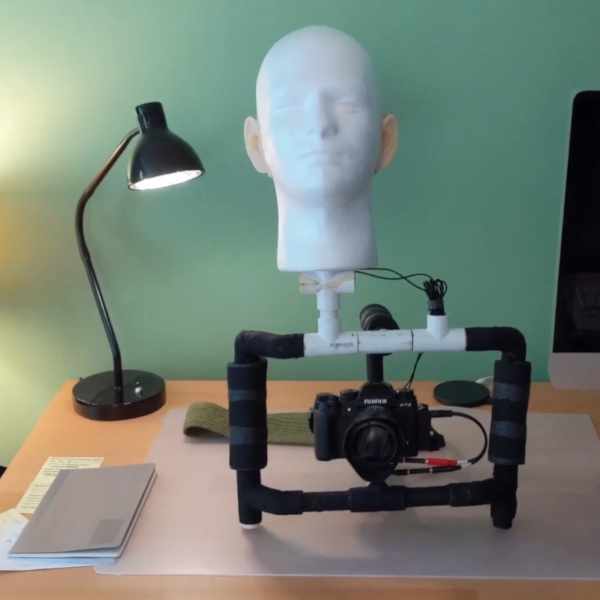

For as many speakers as someone can cram into a surround sound system, humans still (generally) only have two ears to listen to those sounds with. This means that, for recording purposes, it’s possible to create incredibly vivid three-dimensional sounds with just two microphones, provided that there’s an actual physical replica of a human ear attached to each microphone. This helps ensure that all the qualities of the sounds are preserved in a way a real human would experience them, and as [David Green] demonstrates, these systems don’t need to be very expensive.
This build doesn’t just use models of human ears for recording sounds through. The silicone ears are mounted on a styrofoam mannequin head as well, which provides some sound isolation between the two microphones, much like a real human head. The ears are mounted in appropriate locations with the microphones installed inside, and the entire microphone apparatus is positioned on a PVC rig with a camera so that binaural audio will be recorded for anything [David] points it at.
Although he had some issues interfacing two microphones using 19th-century technology instead of soldering everything together, the build still eventually came together, and only for around $70 USD. However, this build is a bit dated now, so prices may have changed by now. It’s still a great way to produce realistic stereo sound without breaking the bank, but it’s not the only way of getting this job done.

If anyone wants to try this, make sure the electret microphone capsules are omnidirectional. Those generally have very flat frequency response for the price. You’ll also want the directionality to come from your ears and head and not from the mics themselves.

No need to place them into your ears. Just use your ears to clip them just above. It is your head doing the major part getting the space capturing. So most important is to keep your head moving slightly while recording. It helps the listener to locate the different sounding objects.

Two electret mics in cheap walkman-style headphone bodies works pretty well. Yank out the speakers, wire up the mic capsules instead. As long as there isn’t too much plastic in the way, it sounds pretty good. If you need more stealth, just put them inside, where the speakers were; you’ll get a slight reduction in fidelity and 3d reproduction, but it’s nice when you don’t want to end up recording everyone talking about your tech setup instead of whatever you set out to record.
If you need higher quality, make the mic capsules more cleanly exposed to the outside sound; your own head does a very good job of creating the correct shadowing and delay.
It’s also a low-cost solution that is easy to experiment with, before you focus on optimizing for whatever your specific tradeoffs are.

Did this myself last year, and unless I got it all wrong, I could discern very little change in the sound colour. (Never tested this indoors, only outdoors.) I’m not sure my styrofoam head was dense enough. The effect was noticeable, it works, sure, but was not worth it for all the looks and questions I got. The head, is actually also a bit big to just drop into a bag full of cables.
The ear and ear canal generates a kind of frequency boost arround 4kHz, where most small electred capsules have some higher sensitivity as they have not a total flat frequency plot. I have reduces this effect with a uneaven formed ear channel (not round, no parallel walls) and lots of cloth. This also reduces the high sensitivity to wind noise. I use the same ears as in the video but with two the ears mounted to round foam discs instead of a full dummy head. This is not so bulky and looks descent when using a ear warmer head band over it for extra wind protection.

No, if yyou go binaural, you also want the face. A lack thereof inbetween the “ears” changes the sound profile.
