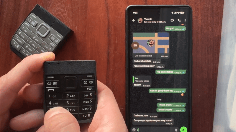

These days, most of us are fortunate enough to use smartphones with decent touchscreen keyboard capabilities. However, once upon a time, if you wanted to type something on a phone, you had to tap it out on the number keys instead. [Jarrett] is bringing that back with a custom T9 keyboard for modern phones.

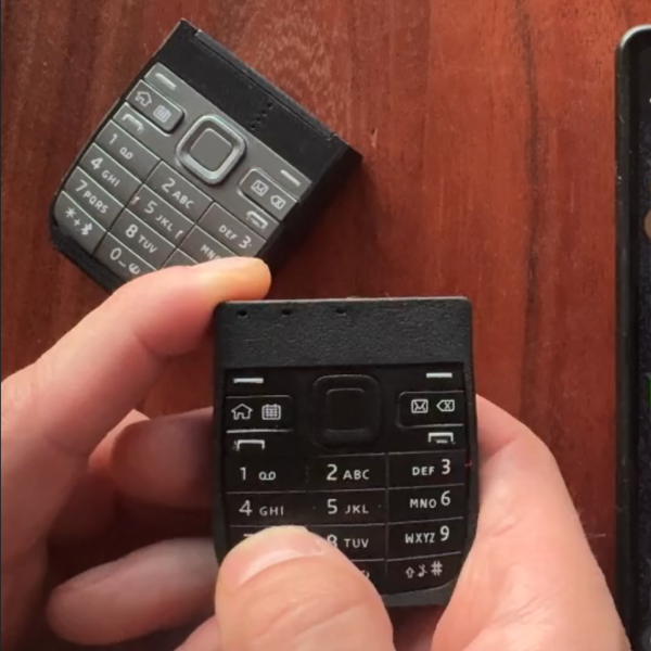

The build is designed around the keypad of the Nokia E52, a Symbian smartphone released in 2009—two years after Apple changed the game with the first iPhone. The phone keypad itself is laid over a custom PCB with Alps SKRK tactile switches corresponding to each individual key. Each is wired with a diode and the switches are scanned as a row/column array as is typical for keyboards. Reading the matrix is an ESP32-C6 microcontroller, which counts the keypresses and spits out the right letters over its Bluetooth connection to an attached smartphone or other device. Power is via a small lithium-ion battery, looked after by a TP4200 charger chip.
Overall, the keyboard works as you’d expect, allowing T9-style input to any compatible device that works with Bluetooth keyboards. [Jarrett] does have one regret, with the 0.98 N actuation force switches used leaving he keypad feeling a little mushy. The firmer 1.57 N switches were suspected to give a more satisfying response under thumb, which was a nice upgrade in the second revision build.

Nice build, but this isn’t really T9. T9 was the predictive text input software making use of the phone keypad. I was hoping to see that being implemented too, but I wouldn’t know how without building some custom text input software on android.
Yep, the demo video shows it’s not T9 since hehas to press keys multiple times to get to the right letter. iPhone (and i believe Android too) have T9 built in, just use the numeric keypad when dialing someone and use the T9 method to start selecting a contact by name. So 7,3,8,3 for Pete.

The source article states that T9 wasn’t implemented and acknowledges that it is only multi-tap.
“… That would have enabled a proper T9 keyboard style, instead of just ABC. T9 requires a dictionary of the language in use …”
