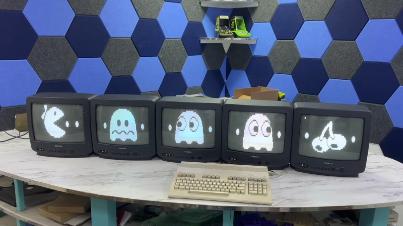

If you had one monitor back in the 8-bit era, instead of having to wait to use the family TV, you were already amongst the blessed. If you had five, maybe you worked at a computer store– but if you did, you could have done what [The 8-Bit Guy] demonstrates in a recent YouTube video and plug all five (5) monitors into a Commodore 128.

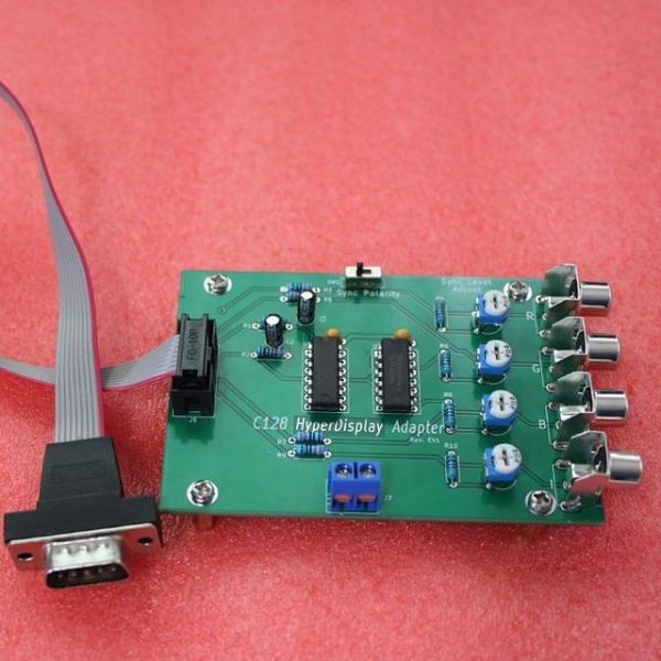

The computer isn’t modified in any way– well, except for the now standard use of an SD card disk emulator– so what gives? Well, you probably guessed he’s splitting up the colour signal into multiple monochrome images, but since the C128 actually has an RGBI, that I– intensity– actually gives another signal that can be broken out. That makes for four screens being driven from that port via composite, all sharing the same sync. The hardware for that was actually designed for [The 8-Bit Guy] by [Joe Burks] who open sourced the design on GitHub. He’s also selling them on Lectronz.
The fifth screen, of course, is driven by the VIC-II chip that Commodore provided for composite output to begin with. The interesting part is as much the software as the hardware, and while [The 8-Bit Guy] explains some of the thinking behind what he’s doing, he doesn’t link to any BASIC. If you know your way around a Commodore, you should be able to encode the multi-colour images required to do the splits.

  1. tl;dr the RGBI output of 128 is split and fed into 4 separate monitors, plus the standard composite from VIC.
    Can only do 4 mono output though, great for long scrolling text at vintage computer shows but not a lot of practical use. I’d file this hack under “Just because they can”
    1. I wonder how tricky it would be to make some logic to individually split out each of the 16 colours. Maybe repurposing luminosity to select the colour or having eight two colour displays.
      1. But you won’t be able to show anything in a position that is showing anything on any of the other monitors.
        With 4 monitors, each can have a full monochrome image, independant of the others.
