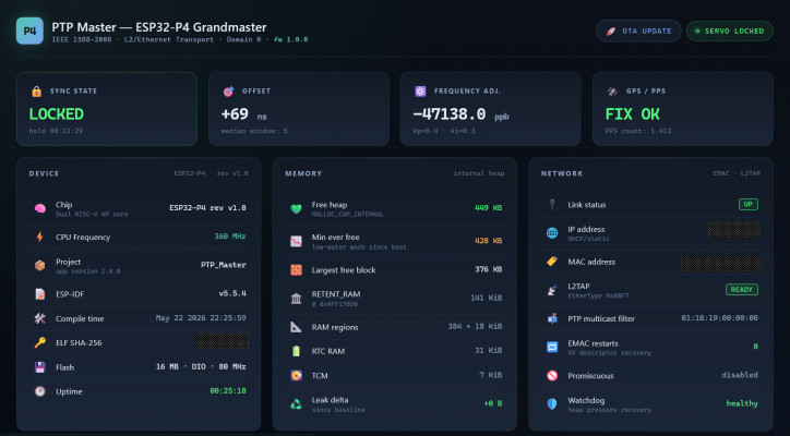

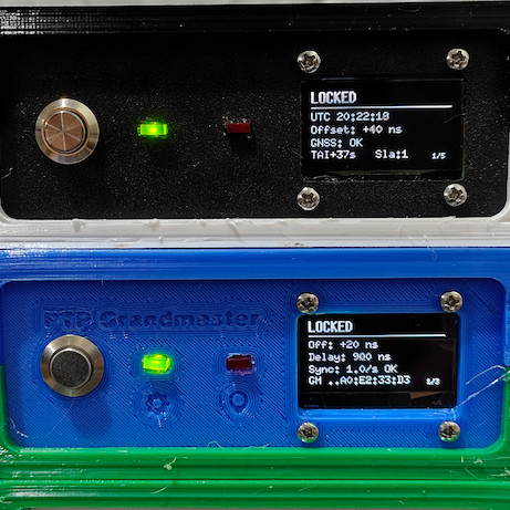

You almost certainly don’t have an application for the sort of accurate timekeeping that’s made possible by this enhanced version of [Cristiano Monteiro]’s satellite-backed time server. By his own admission, the vast majority of users will be more than happy to have their system’s time synchronized by the traditional Network Time Protocol (NTP). But if you’re really chasing those last few microseconds, that’s where the Precision Time Protocol (PTP) comes in.
With NTP, you can get within 10 milliseconds or so of your upstream time source — but PTP is accurate down to nanoseconds. Unless you’re performing some kind of scientific research, running a robotic assembly line, or perhaps doing high-speed financial trading, there’s no reason for this level of accuracy. In fact, PTP is such a niche technology that until the release of the ESP32-P4, [Cristiano] couldn’t even find an affordable enough chip that supported it.
Hardware-level support for PTP is important as there’s no way to achieve this level of accuracy with software alone, the capability needs to be baked into the Ethernet controller. As you might expect, it takes a highly accurate time source to make the most of PTP, and that’s where the navigation-grade Global Navigation Satellite System (GNSS) receiver comes in. All told the cost of the build is unsurprisingly higher than that of its predecessor, but [Cristiano] says it’s still a couple zeros shy of what a commercial offering would run.
As with his original time server from 2021, [Cristiano] made sure this build was as friendly as possible for hackers and makers. We especially like the 3D printed case designed in OpenSCAD, and his insistence that the gadget have a front panel with blinking status LEDs. Again, the vast majority of us don’t need our clocks to be accurate down to the nanosecond…but it’s nice to know we have the option.

One thing I did in this build that I didn’t in the previous one (the NTP/RDATE box) was to force the GNSS module into stationary mode. Some GNSS chips will allow you to configure some parameters to instruct the chip that it is in a stationary position and not in movement, and all the computing should be dedicated to timekeeping. This should shave a few nanoseconds and make the machine even more accurate.
So far I could identify only one low cost GNSS chip with such capability for which a genuine one can be acquired on the usual places with little trouble, it’s mentioned in the article. Feel free to reach me so I can point you right. The machine will take the first 15 minutes (configurable) calibrating itself for this fixed position and commit that to the module RAM and assume you will not move it anymore. To restart the calibration you need to reboot.
Still finishing the PTP slave code and will upload it soon, so, recommend you to acquire at least two of the mentioned ESP32-P4 boards if you don’t have a PTP client immediately at hand to test your Grandmaster against.

Where is the OpenSCAD script that made that enclosure?
Hi Winston! Maker/Author here!
Just uploaded it, you can find now under GNSSTimeServer/src/PTP/resources/
I reused the brilliant “The Ultimate Box Maker” by Heartman/Heartym, which can be found here: https://heartygfx.blogspot.com/
Regards,
Cristiano
