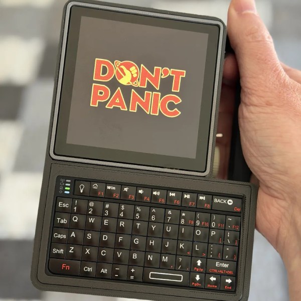

Get A Handle On This Compact Pi Portable
Between the speed and reliability of modern desktop 3D printers and the abundance of powerful single-board computers, there’s never been a better time to build a personal computing device that bucks traditional forms for something more bespoke. Whether you want to go all in on Gibsonian cyberdeck aesthetic or a distraction-free writing device to take notes on, there’s no shortage of examples out there that you can turn to for inspiration.
A recent entry into the field, the Don’t Panic Cyberdeck from [Paul Rickards], is a particularly approachable specimen for those looking to experiment with alternative computing experiences. While the final product certainly stands out among the throngs of nearly identical laptops, it doesn’t take a huge investment in time or money to put one of your own together.
Which is not to say the project is simplistic, exactly. Rather, as [Paul] released the design under the Creative Commons license and was kind enough to provide not only a detailed Bill of Materials but assembly instructions, the community is able to benefit from the sleepless nights he no doubt put into it.
In it’s baseline configuration, the Don’t Panic uses a Raspberry Pi 3A+, a Pimoroni HyperPixel 4.0 Square LCD (touch optional), and a Rii 518BT keyboard. Those core components would be enough to get you up and running, but if you want battery power you’ll also need to add a LX-2BUPS UPS board and a pair of 18650 cells. Audio might be nice as well, and for that [Paul] recommends a PAM8403 breakout board. He’s even got a printable volume knob that slips over the board’s potentiometer and peeks outside the case.
Of course, the best cyberdeck builds are customized to meet their owner’s specific needs, so your loadout doesn’t need to match [Paul]’s exactly. Except the handle, anyway. That feature is non-negotiable. Mainstream computers have far too few handles for our liking.

  2. I hate every single thing about this build! I can find nothing positive to say. And yet my printer is already printing 3 of these. Why? Because there’s something genetic programmed into me and people like me that since high school we dreamed of holding a real Linux computer in our hands. Remember Gumstix? I appreciate the effort that went into this. Thank you!
  3. First, it is slightly cheaper. Second, it has the words “Don’t Panic” printed in large friendly letters on the cover.

  5. I like it, but i don’t like the fact that 99% of small handheld builds need to use tiny off the shelf Bluetooth keyboards. I wish it was easier to make keyboards.
    Silicone keypads can be a used but getting them made custom is expensive. The only other alternative that i can think of is making a single piece 3D printed button matrix out of plastic, and using SMD buttons on the PCB.
    1. “Need to use” isn’t really true, as it isn’t that hard to make keyboards. However those off the shelf small keyboards are cheap and nice enough for what they are in my limited experience of exactly one of them. Also seem to be quite available in the same case dimensions for a while at least, so cheap and relatively easy to get for anybody replicating it is hard to argue with.
      You can and some folks have used small tactile switches on their custom PCB for instance, but 30 odd switches for a minimum viable keyboard and the custom PCB + RP2040 or something (assuming your projects brain can’t run the keyboard matrix on top of its primary functionality too) is quickly getting into a better invest $100+, as buying just the bare minimum of the components to build one if you can source so few at all is expensive, so you end up with enough bits to make a few… (unless you already have stuff in stock of course).

  7. Looks cool! Even has keyboard with function keys (Fx).
    The only minor “flaws” I can see is that it lacks an RS-232 port and doesnt’t natively run DOS (due to Pi 3)! 😁

  8. Definitely not a cyberdeck since it is fully assembled all the time and doesn’t need to be assembled out of discreet parts whenever you use it like the books of the day described, and is even portrayed in the Johnny Neumonic movie.
    But is SURE IS COOL!
    We need a name for this form factor!
    The speak and spell, non folding, top-half screen, bottom-half keyboard/input…
    It gives huge early sci-fi anime in space computer vibes too.
    KeySlab?
    KeyTab?
    Slablet?
    Help me out here.
