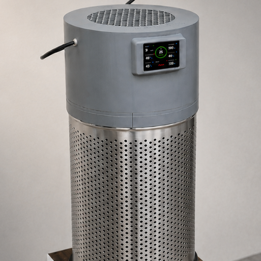

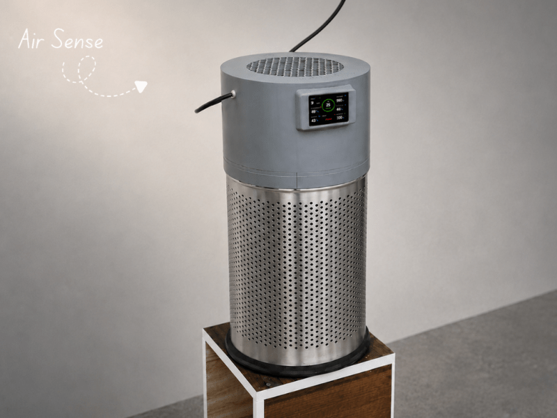

A vaguely perforated metal cylinder sits on a wooden box with a grey cylinder and LCD display atop it. There are holes in the top of the grey cylinder for air to flow through.
As predominantly indoor creatures, it’s important to maintain a healthy habitat for the hacker. [Kishan Pratap Singh] designed a clever solution in AirSense, an ESP32-powered air filter.
If you’re thinking of cleaning the air in your environment, you might also want to know some properties about the air coming out of the filter. AirSense measures PM2.5 dust concentration, Air Quality Index (AQI), temperature, humidity, and atmospheric pressure. The various sensors are mounted along the exhaust path of the filter, which lets your know what kind of air it’s pumping out.
The system drives a 150 mm exhaust fan mounted in a 3D printed cap that pulls air through a cylindrical Xiaomi HEPA filter inside a perforated metal trash can enclosure. The ESP32 and an LCD readout of the environmental data also live in the cap, giving the device a sleek look. While [Singh] chose to run the filter continuously, we wonder if it might be interesting to set it up to only filter the air if air quality drops below a certain level to conserve power, especially if you’re on a time-of-use power plan. That would require redesigning the sensor assembly (or running the unit in reverse), so maybe it’s over-complicating things?

    1. The fan is rated for 300 cubic meter per hour. In reality, it’s probably half of that because of the filter’s dampening, but 150 cubic meter per hour is a large processed volume. If you live in a 100 sq m condo, with 2.5m ceiling height, this system is processing the whole volume in 1h40. This leads to another “issue” in the design, there’s no way the HEPA filter will keep filtering such a volume for long. It’ll saturate with dust in few hours (maybe days) and then be useless. It needs to be protected from the particules that could cover its hole size first, with a standard filter that will have to be washed often to work. So this gizmo isn’t actually doing what you’d expect it to do, there’s a reason air filters are made with multiple filtering layers.
        1. yeah if we’re going to be collecting data about this unit, the data i want is how much air actually moves through the filter. i have been under the impression that this sort of fan isn’t good at back pressure at all, but i’m not an expert. i would personally be drawn to a bathroom fart fan if i was designing something like this, which is a tiny squirrel cage fan in a cheap standardized size
        2. Yeah. A MERV13 with a 20 inch box fan will flow MUCH more than this, let alone a corsi-rosenthal box with four MERV13s (which actually flows more than 4x because the fan doesn’t handle static pressure well)
      1. Yeah, but it’s going to do that no matter what… the telemetry is redundant. If anything you would want to know what the overall air quality is, not just what’s coming out of the filter. That tells you nothing about what you are actually breathing.
        1. Agreed that monitoring the air coming out of the filter is pointless. Unless you maybe suspect you were sold a fake HEPA filter, you should be able to assume the air coming out of the filter is clean. The real, more interesting question is: How dirty was the air before going thru the filter?
