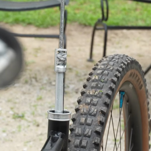

A recent addition to mountain bikes is the dropper seat post. This invention is in the vein of office swivel chairs, allowing the seat height to be adjusted with a simple handlebar mounted lever. They are rather fascinating inventions ranging in complexity from simple mechanical systems, to electronic monstrosities actuated by Bluetooth. Inspired by the panoply of possibilities, [kane components] set forth to create such a home-built dropper post.
Inspired by woodworking bar clamps, [kane’s] design utilizing angled plates binding against a rail inside the dropper post. Two pairs of plates sitting at opposite angles resist opposite forces from either the rider sitting on the post, or the return spring. A simple cable actuated cam moves the plates to a nonbinding position when the lever is actuated, and springs return the plates to a binding rest-state. The return is handled by an air spring pressurized against a piston at the bottom of the shaft.
Though 3D printing could be used for a cursory test the mechanism, properly machined parts are needed to handle the loads running through a typical seat post. But instead of machining everything from scratch, [kane] reused the lower post and bushings from a broken post. To fit everything together, the lower post got thread milled so the entire mechanism can be threaded into the seat post as a replaceable cartridge. The upper telescopic section consists of aluminum tubing and a custom machined seat clam mechanism press-fit together.
As is the case with all engineering projects, a number of issues came forth once the dropper post made it onto a bike. Issues ranged from the cable pull causing the seat post to move slightly, to all manner of mechanical jamming. Filing down the ball end of the cable so it didn’t rub against the outer-housing of the seat post fixed that particular issue. The two-piece upper design also proved problematic with the press-fit having a bad tendency to come apart.
Despite these particular issues, did it end up working? No, not consistently. The binding mechanism does not consistently produce enough force to keep the dropper post from falling under a rider’s weight. Regardless, we really enjoyed following along with [kane] for the journey of creating such a mechanically complicated bicycle component!
